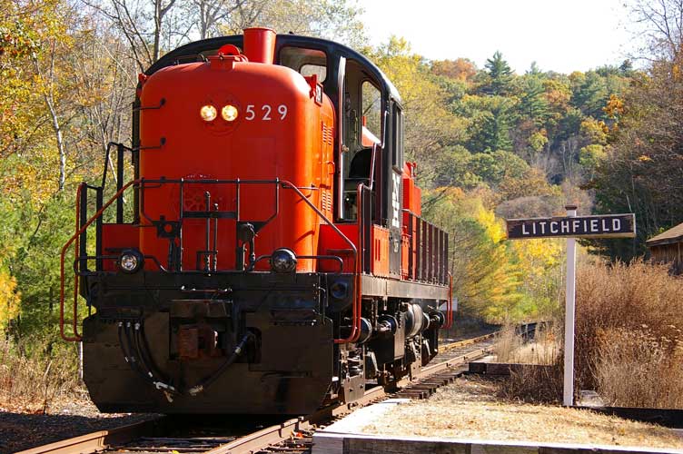

Presented for your viewing pleasure is a locomotive (RMNE owned ex-NH RS-529) painted with Dupont Centari (using the hardener package) way way back in 1991.
A good deal of the locos' surface area was taken down to bare metal using mechanical methods-which would be sandblasting and/or needle scaling. Paint was applied with a HVLP setup. Truly a first class job...
I note that this loco actually looks far better in reality than what is depicted within the photo. Gloss retention is excellent (in both the black and orange portions) and there is no sign of chalking or color shift in the orange.
DPK

The project to properly repaint and prepare NH 529 for operation started at the beginning of the 1993 restoration season, at RMNE's outdoor Saybrook Yard. The mechanical work and some body prep took place during 1993, and by the end of the 1994 season, the body was about ready for painting. Every door and hatch that could be removed was taken into a boxcar "sandblast booth" and taken down to bare metal, then primed. The non-removable parts (cab, both hoods, tanks, frame, end plates, steps, etc) were needle-scaled and disc sanded to bare, and then primed.
By late fall 1994, the loco was ready for final paint and was primed with DuPont 2600-series primer-sealer inside the VRR's Essex enginehouse (529's topcoating was the last RMNE project done inside that building). Then the final topcoats of red-orange and black Centari were applied by RMNE personnel. The painter (ZOG) and his helper (HP) each had air-supplied hoods, full Tyvek coveralls (with feet and hoods), gloves, etc. The air compressor for the hoods was placed outside the building....
529 was completed at Saybrook in the 1995 season (new radiators and rebuilt shutters, water and oil piping, etc), and moved to NAUG in Sept. 1996, where it has operated every year since. It has lived outside almost all the time since then, and still looks very good.
529 gets washed about once per season, sometimes 2-3 times per season, and its been waxed/buffed maybe 3-4 times in the 14 years since being painted. Annually would be better for that task.
Lesson here? Do the very best surface prep job you possibly can, use the best materials you can afford (and that you can safely/properly use), and try to keep the things under a roof!!!
