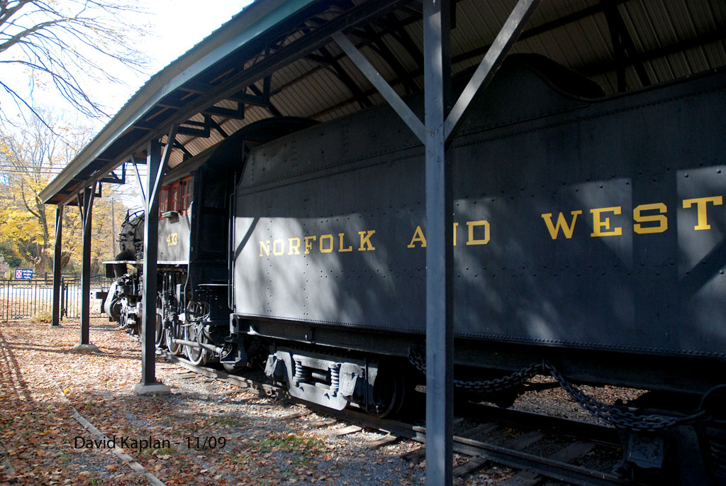

Paul -
If you're going to be designing and building one of these shelters from scratch, try not to build one like that covering Georgia Northern 2-8-2 #105. The posts are too close to the locomotive for photography. It's okay to keep them close on one side (for visitors to get next to the engine), but try to move them back from the loco on the other. The Antigo, Wisconsin shelter is much better, but the posts are still too close on one side and blocks the locomotive from decent "wedge" photos. Yes, I know that moving the posts back means increased costs, but if you're going to build such a structure, do it right the first time. My opinion only of course.

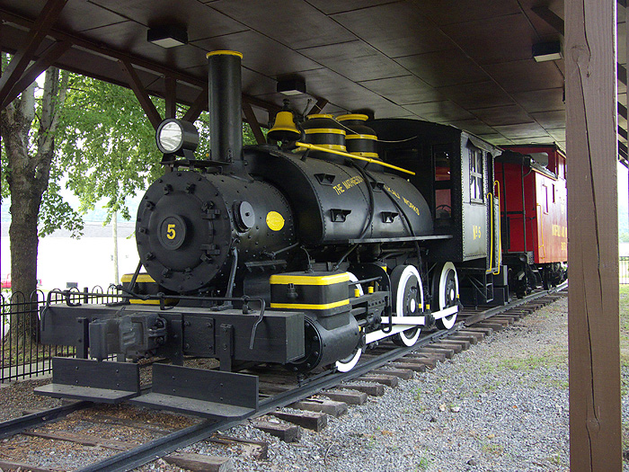

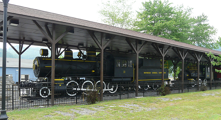

Whatever style you choose, I would recommend a smooth finished surface under the roof to prevent birds from nesting.
Alan Maples
File comment: Display shed at Saltville, Virginia.

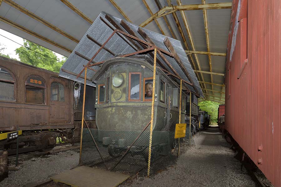

Here's, um, two.
File comment: I herd u like roofs
 Post subject: Re: RR equipment under cover - examples?
PostPosted: Fri Jan 20, 2012 11:50 pm
Hey Robert, whats with the guy in dreadlocks peering at us from the cab of the little electric?
PostPosted: Sat Jan 21, 2012 12:11 am
Joined: Tue Sep 21, 2004 1:32 pm
Posts: 114
That's the host of the TV show Overhaulin'. Pretty appropriate considering the work being done.

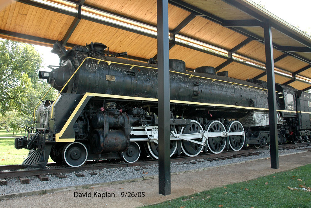

Here are a few more examples. The first in Abingdon, VA and the other in Nashville. I hear the Stripe in Nashville has been cleaned up a bit since.

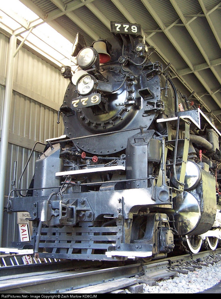

Posts: 1084
nkp 779
