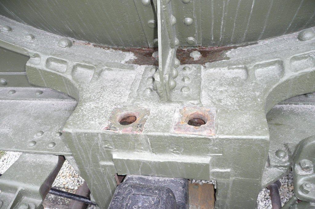

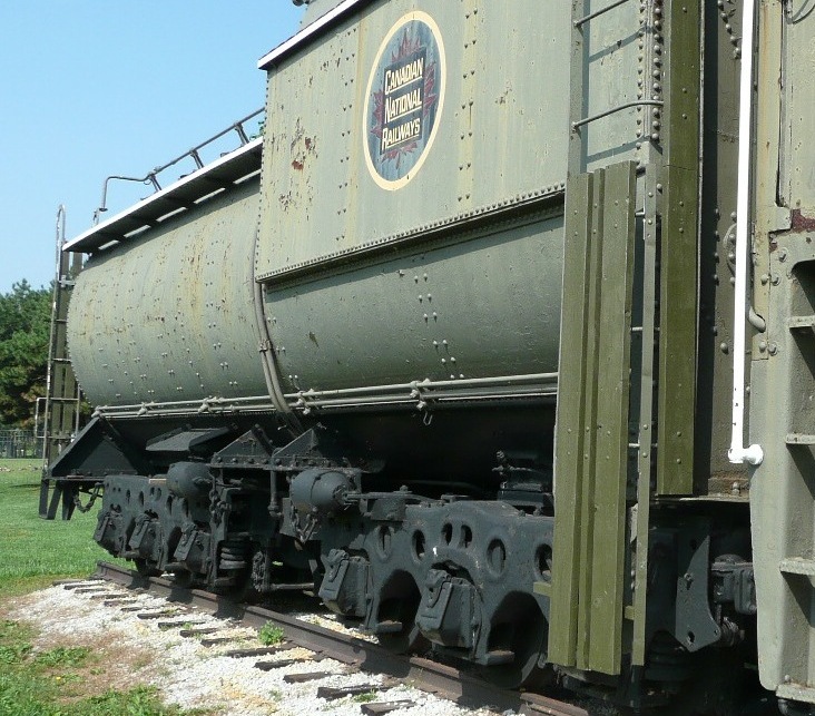

I have a question regarding these Vanderbilt Tenders see attached picture. On the rear end of this tender above the Knuckle, there are two large round holes which appear to be drain holes but I was wondering why they would be there? I managed to open them back up as they appear to be full of track bed dirt sand etc.. Can anyone shed light on these??

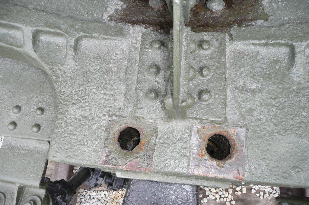

I have taken some pictures that better describe the drain holes. What we are wondering, if these are in case a leak develops on the bottom of the tank where it sits in the rear frame and the water runs along between the tank and frame and runs out these holes?? I wish CN had put drain holes further up near the face of the tank as it always collects water there and as you can see by the pics, the joint where the tank meets the frame, always rusts out..

Just to clarify, the square areas around the holes are from aluminum plates that I had fixed over the top last year to stop water getting in. The areas need to be cleaned and repainted this summer.

These could simply be holes that were put in the casting to simplify handling/ machining.
They appear to be cast in, not machined. Usually a mounting hole would be drilled.

I think you ought to consider that they are just "core prints" (not really absolutely correct use of the term) that provided support for the sand core that formed the interior volume of the casting, and served absolutely no other purpose after the casting was poured. An alternative method of providing support for cores that are difficult to support is "chaplets", little steel spools that become part of the final casting, but they have their own issues.
