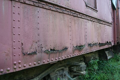

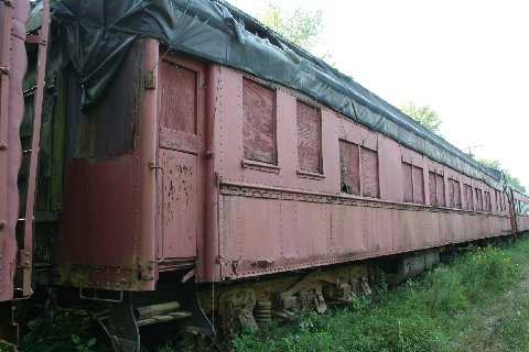

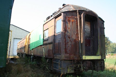

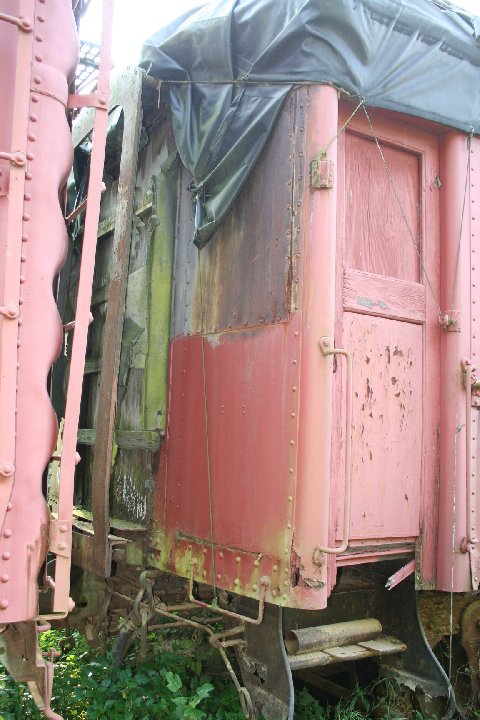

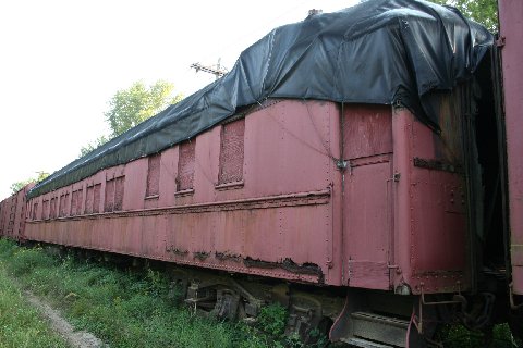

Perhaps someone in the know, might be able to answer a question that has eluded me.... In French Lick Indiana, rests this weathered heavyweight.... After looking closely at it, and the window configuration, I have been unable to determine the history, railroad, builder of this car....
Maybe the vast knowledge on this forum might have some information on the history of this unique neglected heavyweight...
Thanks in advance
Dean Levin

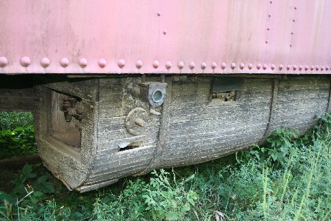

a few more photgraphs
Dean

Railroad escapes me, but the car is a rare Barney and Smith sleeper from the early teens. I have been advised it arrived via private owner at Mid Continent. The interior is tough but in its day it was a real beauty with color glass domes, gas lighting, and more.

Looks like a Milwaukee Road car to me.

I agree the car is an early steel car built by Barney & Smith, but the three single windows with high sills is a hallmark of the B&S 12-1's, and I wasn't aware that the MILW had B&S 12-1's. I'd say it's a Soo Line car.
I have one Soo B&S 12-1 listed as being at Wells, MI... Soo 1237, named BEMIDJI, built by B&S in 1913. As I recall, this car went to Nevada City, MT, possibly coming from the defunct display at Hayward, WI, and then to John Larkin of the E&LS... but it's possible it was traded to someone else. The only problem is, it has the wrong trucks for a 1913 Soo car... but then the Soo did swap trucks.
These are the right trucks for the 12-1's built by B&S for the Soo in 1911... and most of those cars I don't have disposition information, other than "retired, 2/62." None of the 1911 cars seemed to have been converted to work service, and three of them went to the DSS&A in the thirties, although two of the three were rebuilt into a six section - coach configuration.

Found my notes courtesy of the fine folks at Mid Continent: It was built for the Soo Line as the "St Paul." It was later sold to the DSS & A and retired in 1963.

Cool. I didn't realize that two of these early steel sleepers had been saved. When built for the Soo as the St. PAUL, it also carried number 1234, and yes, it was a 1911 B&S product, Order No. 2596.
After the sale to the DSS&A in 1934, it was renamed MARQUETTE, with no car number, until it was retired to work service in 1957 and and renumbered 845. Apparently it was never actually used in work service, and was sold to Mid-Continent, date unknown. Mid-Continent sold the car in 1983, and it was moved to French Lick, IN.
Most of this information came from Ray Buhrmaster.
At least the car has a tarp on it, but it looks like it has taken a lot of watter through the window sills.

I may be responsible for the confusion, confusing this car with the Soo BEMIDJI, which was both at Nevada City and is now at Wells. The Soo Line St. PAUL appears to have gone from the Soo --> DSS&A --> Mid-Continent --> French Lick, and was never at Wells
Interesting side note... Both the Soo Line and DSS&A named cars almost exclusively after on-line communities. When the Soo sold three out-dated steel sleepers to the DSS&A in the mid thirties, allowing the DSS&A to retire the last of their wood sleepers, they were named DULUTH, SUPERIOR, and St. PAUL. Well, the DSS&A went to both Duluth and Superior, so those were OK, but they didn't go anywhere near St. Paul, so they felt compelled to rename that car, choosing to name it after Marquette, MI, the third car on their small roster to carry that name.

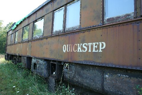

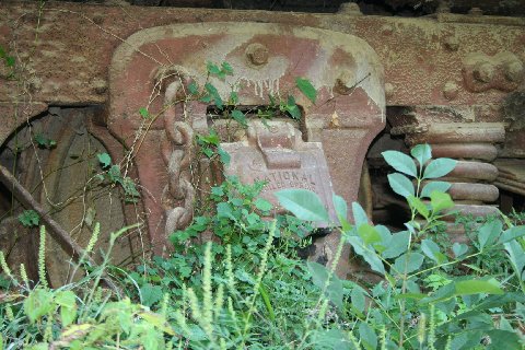

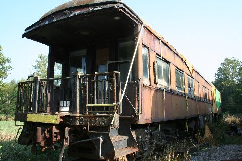

speaking of neglected heavyweights in French Lick... any one heard truth to a story of the private car "Quick Step", ( Clover Leaf RR 400 , Nickel Plate 3 ) being sold to the Mad River and Nickel Plate Museum in Ohio ?
thanks
Dean Levin
