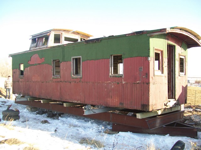

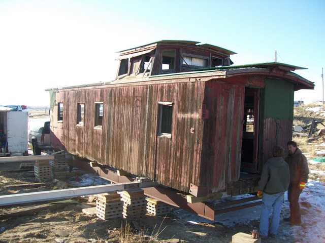

Today saw the completion of the lift and the sideways move onto the frame, all went well despite the NE corner whch is entirely detached from the side and rotten end sill. We will have to replace the East end sill. But great to see her on a level foundation for the first time, hopefully the move up the road will be completed on monday.
Mike Pannell
Cheyenne
