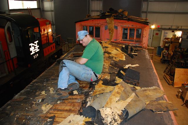

Allen Pomeroy (car's owner) starts the removal process on CV 4014:

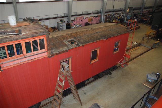

The cupola roof after removal of canvas and rotten tack molding:

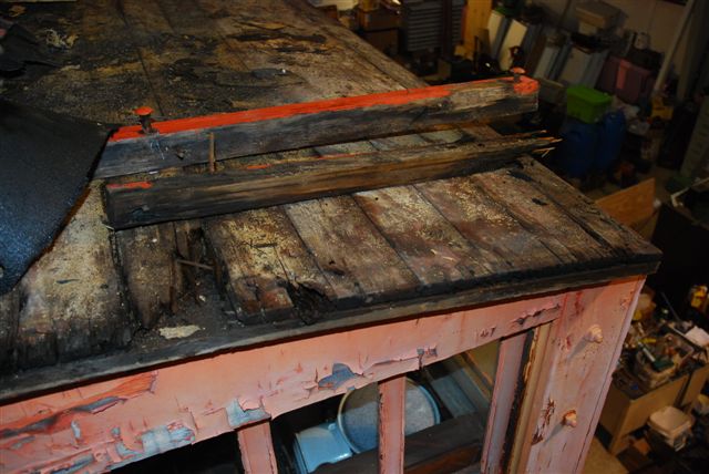

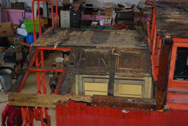

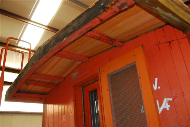

"Short end" of roof; the yellow panels are the inside doors of the lockers in that end of the car.

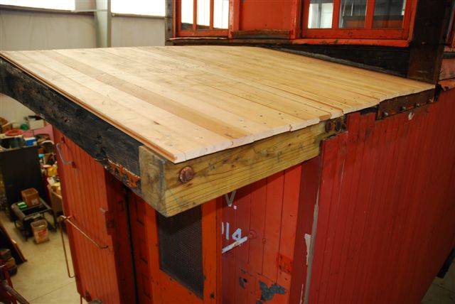

"Short End" redecked with new T&G material:
Underside view of "short end". Every bit of original wood that was in good condition was reused or left undisturbed.

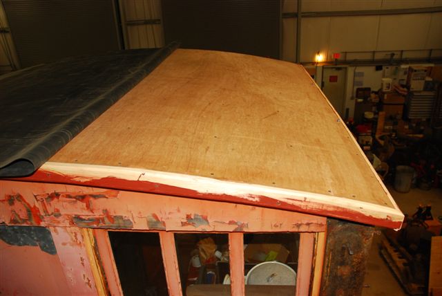

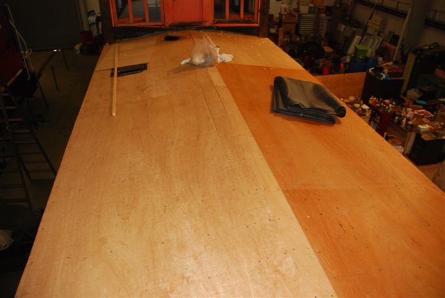

The decision was made to overlay the wood deck with 1/4" Luan plywood, to provide a smooth surface for the EPDM membrane:
The cupola roof, with new tack boards along the edges and Luan deck, ready for the EPDM membrane (pre-cut and ready for application):

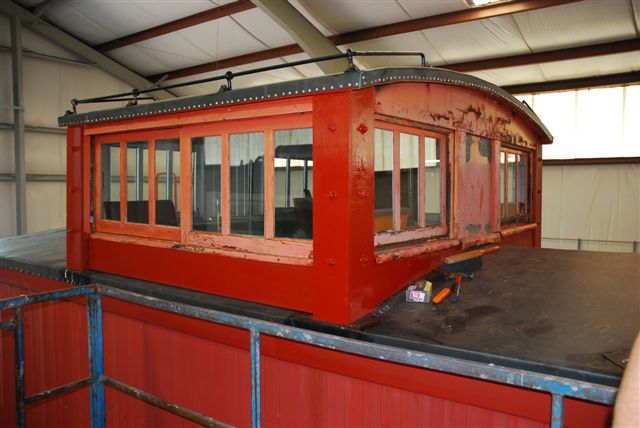

The EPDM membrane is now applied and the steel parts of the cupola have been primed. The edges of the roof have been nailed as per original. Note the folded edges on the cupola roof.
