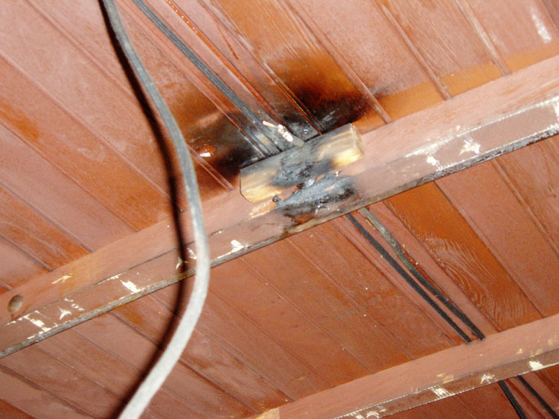

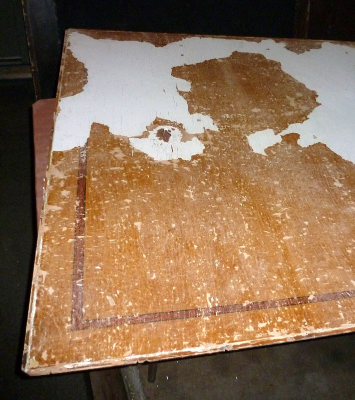

Below are some photos of our Museum's "mother car," the subject in this story of arc faults (I've never heard of them--not an electrical engineer). One shows the burned wood where the lighting fixture was mounted. We surmise that the arc formed from the steel reinforcing piece to which the wood carline is bolted. This steel band, which is tied to the steel girders making up the side frame of the car, goes up the window post, forms the curved side-roof and clerestory and then down to the opposite side frame girder. Aside--TCRT's standard cars main frame was built like a bridge member and were produced by the American Bridge Company in the beginning. After 1898 all of TCRT's passenger cars and most work cars were built in TCRT's own shops.
The bad wiring in question is probably original from the early 1930s, when the interior lighting configuration was changed when the car was converted to one-man-two man operation. The wiring was covered with painted ceiling panels so there was no easy way for us to inspect same. After this near-miss, our shop guys took out the ceiling panels and re-wired the ceiling lights using modern material. In the process of removing the panels, the old white paint flaked off in hunks revealing the original pin-striping and faux-wood finish of what appears to be an early masonite-like material. Since we maintain No. 1300 in its June 1954 appearance, this old paint has been removed and the panel re-painted.
