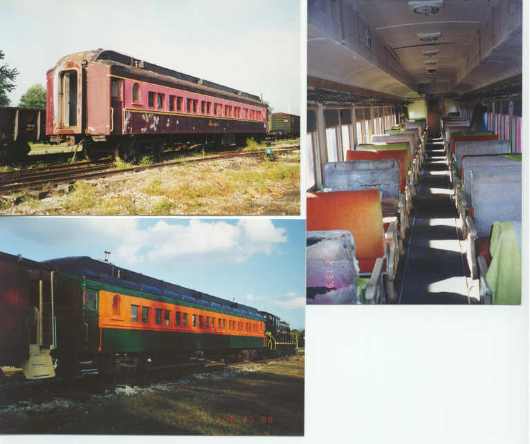

Talk about a jolt! This car looks like a sister of a WP/D&RG/D&RGW/AC&HR/MN/BCRC/KLS&C car that is located at the Hoosier Valley Railroad Museum in North Judson, Indiana. That coach was built by Pullman for the Western Pacific in 1910 as part of its initial large order of passenger equipment. The car is currently privately owned (I am one of the owners). Note that the car also had its upper windows sashes "blanked over" just as on the Maine Central car.

I don't know how similar the MC car is to the WP car, although the carbodies look similar. The WP cars have 2-axle trucks.
If I interpreted what I saw correctly when I was in these cars on the KLS&C, they are interesting in that the heavy girder panel is on the inside wall of the car, next to the seats. The outside panel is thin sheathing. This feature would tell you if the cars are similar.
I also remember the extensible steps under the main steps that were attached to the traps, and enough water in the light fixtures to support fish. Speaking of fish, those trains were passed by the minnows swimming in the lineside ditch.
