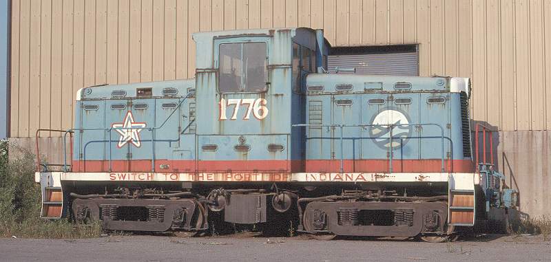

The Hoosier Valley Railroad Museum in North Judson, Indiana also has an Army "veteran" on its roster. Our Whitcomb 44-ton center cab diesel is s/n 60105 built 8/41 for Day & Zimmerman, a weapons contractor in Iowa, where she carried the road number 4-44. Apparently the operation there was taken over by Uncle Sam as the Whitcomb became U.S. Army #7308. After being declared surplus at the end of the Second World War she ended up working for McGraw Construction Company (number unknown), then Chicago Gravel as their #509 finally ending up at the Port of Indiana where she was painted in a Bi-centennial red/white/blue scheme and numbered 1776. She was eventally purchased by an individual who donated her to HVRM where she currently is painted black with yellow lettering and carries road number 27 (just above Erie 44-ton GE number 26). I will try to post a photo of her in her P of I paint scheme. BTW, she IS operational although our operating department says they are currently having some problems with her generator.

RE: The Hoosier Valley Railroad Museum locomotive, Tourret's book lists the following:
USA 7307 has serial number 60105, was built in 1941, and was Iowa Ordnance Plant 4-44. USA 7308 has serial number 60106, was built in 1941, and was Iowa Ordnance Plant 5-44.
Note that serial number 60105 is for USA 7307, not 7308.

Tim -
Thanks. I am going to try to check our museum records to see what I can find. Is our unit USA 7307 or 7308? More later.
