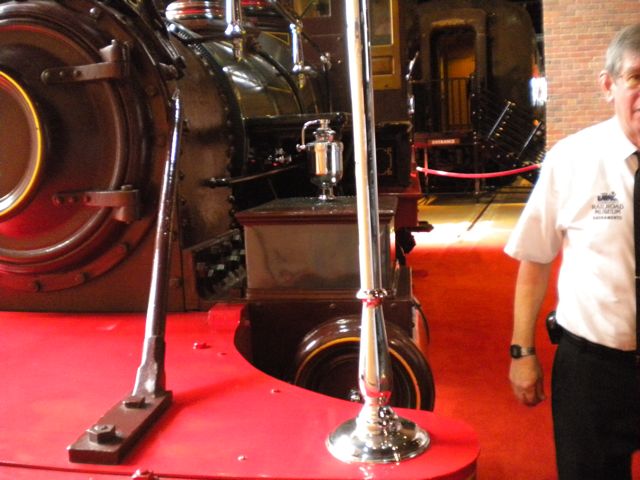

I was at CSRM the other day, which has a breathtaking collection of 19th century steam, typically American (4-4-0) type. I was looking at them with a docent, and we were wondering how steam gets from the boiler into the steam chest. There didn't appear to be any pipe connection from boiler to steam chest, save for very small (1" or smaller) pipe. Nor any exit from the steam chest to the exhaust stack. Is this a case of faulty restorations which omitted that piping? Or is there another path not readily apparent? And what is that bowl up top of the steam chest?

Robert, those engines, and many others prior to the advent of superheating, use slide or flat valves. These are a type of shaped plate that slides over the steam ports, and are usually noted by a square box above the cylinder, as in your photograph.
Steam piping is all internal, inside the cylinder block:

As to your other parts, the thin pipe you saw was likely a lubrication line, running from a displacement lubricator in the cab to the cylinder block, and routed under the boiler jacket.

The device on top of the valve box looks like a "snifter" or "anti-vacuum" valve to let air into the cylinders when the engine was drifting with the throttle closed. There was a possibility that the vacuum that would form without this device would suck in smoke and other things from the smokebox into the cylinders, and that wouldn't do pistons, rings, valves, etc., any good at all.

The nicely polished bowl on the top of the Valve ( or Steam ) Chest is a lubrication pot.
In the early days, hot tallow was kept on top of the boiler in the locomotive cab. The fireman had to walk out the front doors of the cab when drifting downgrade, shut the steam valve at the bottom of the Tallow Pot, open the top ( at the risk of being splattered and scalded if there was residual steam pressure ) and pour hot tallow into the pot. Add: Rain, Snow, Ice, Jerking motion of the Locomotive in Motion.
Hence, the moniker " Tallow Pot " also refers to the Fireman in North American slang.
This method became obsolete, or at least secondary, with the development of the Displacement Lubricator, which was mounted in the cab, and delivered what evolved into Steam Cylinder Oil, 95 % heavy petroleum mixed with 5 % tallow and emulsifiers ( Phosphate ) which form an oily foam in the steam. http://www33.brinkster.com/iiiii/mccoy/

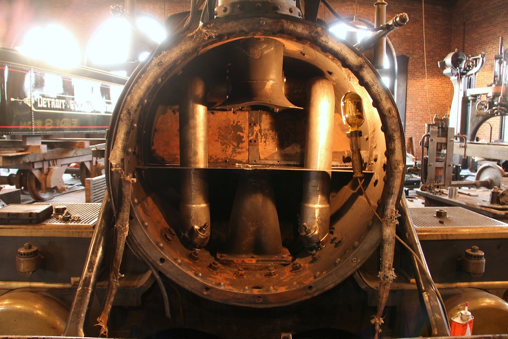

On a similar locomotive, inside the smokebox you can see the branch pipes that admit steam to the steam chests.
In the picture of the 4-4-0 Edison, you can even see the studs on top of the steam chest where similar steam cylinder oil lubricators were once located. Currently a Manzel mechanical lubricator supplies the oil.
Keeping the supply of steam internal keeps the steam from condensing.

I thank 0-6-0 for setting me straight that I was looking at the old tallow-pot lubricators instead of snifter valves, but now I have a question--where are the snifters on the portrayed 4-4-0 in Mr. MacDowell's original post? They are quite prominent in the photo of the Edison (they are the cylindrical objects with the holes around the top edge on the fronts of the valve chests), but there is nothing similar on the unidentified 4-4-0.
And which engine in the collection is it? There isn't quite enough of it visible to identify it, at least not easily, although it looks like it might be from the V&T.

Simple answer to the snifter question, snifters are an accessory, not a necessity, many locomotives were built without them. GM&N 425 only got hers after being restored to service on the Blue Mountain and Reading, they are simply swing checks mounted to a street elbow and replaced the "house" valves installed by Baldwin. Drifting was done with a slightly cracked throttle, K4 1361 has a drifting port on the outside of the throttle casting and was designed so that the first 3 or 4 throttle notches would open the pilot valve and allow sufficient steam to carry the lubricant to the cylinders. When using saturated steam lubrication was not as critical as with superheated steam, as the condensate worked as a poorman's lubricant. The flat surface of the slide valve was hard to lubricate at the edges of the passages way which would cause higher levels of wear and lead to superheated steam cutting of the seating surfaces, which led to the widely accepted piston valve.
