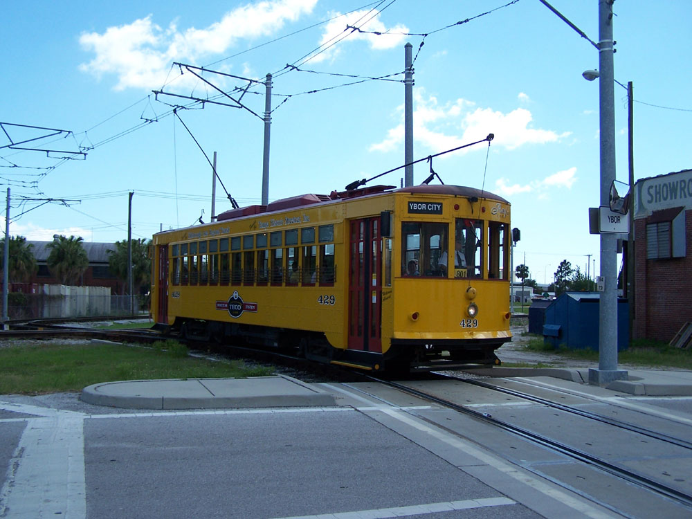

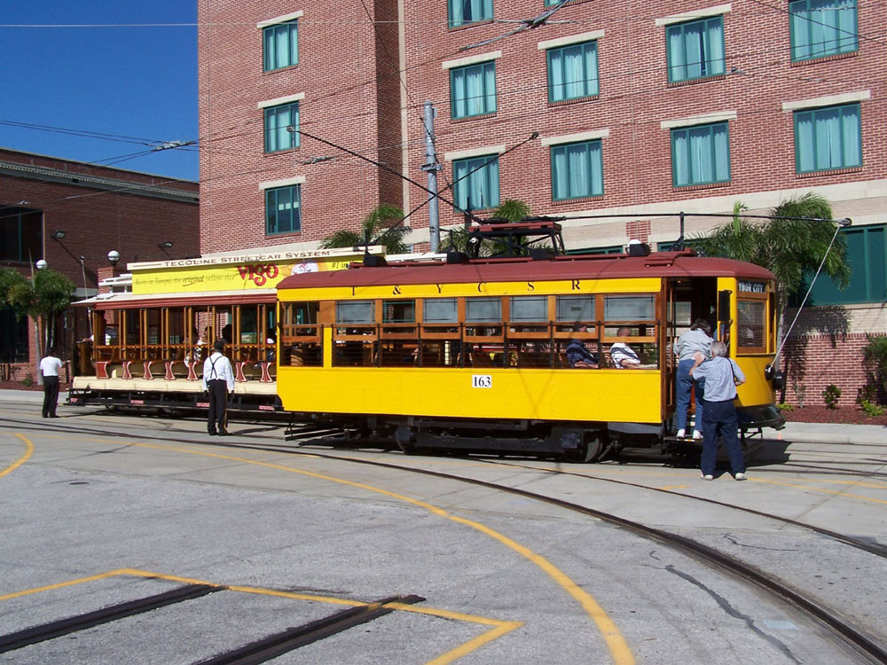

Here are a couple of photos of the Tampa/TECO line taken while attending the ARM spring meeting in 2008. Tampa actually uses some electric trolley bus overhead fittings including at least one movable point crossing frog. I believe that is the device shown on the trolley wire directly behind the Birney car. Trolley bus overhead curve segments are used in the carbarn yard. One lead to or from the carbarn is shown in the foreground in this photo.
The other photo shows the double overhead with the car having just passed over the diamond with the CSX and Amtrak into Tampa. Double overhead was relatively rare, mostly used where overhead wire frogs were avoided for whatever reason. Having double wire does help with the ampacity of the overhead but it also costs double to hang. Generally, railways had one or more heavy (e.g., 750,000 or one million circular mil) feeder wires with taps to the overhead contact wire every 1,000 feet or so. Generally, the heaviest overhead contact wire used by a standard street or interurban railway was 4-ought wire--pretty big stuff and usually used on mainline railroads or very heavily travelled lines such as in a big city downtown where it was prudent to have heavier wire because of the rush-hour loads and to reduce the frequency with which the trolley wire had to be replaced because of wear.
Speaking of wear, the Pacific Electric actually used steel overhead contact wire in several locations to try to cope with the wear problems they were having.

I have never seen the Tampa operation, but in looking at Jim Vaitkaunas' photos, I was astonished at the complexity of the trolley wire! It appears to me that the designer was familiar with catenary design for pantograph operation on electrified railways and light rail lines, but was completely unfamiliar with streetcar wire design. The use of a trolleybus type powered wire frog tells me that he felt uncomfortable with the use of rigid streetcar wire frogs, and went to the double trolley wire to avoid their use. There are several ways to provide ampacity that are less expensive than double trolley wire, including using 4/0 rather than 2/0 trolley wire, or using a relatively small feeder, such as 4/0.

Having been in Tampa for 10 days attending a conference, I have had time to further study the wire system. As Art and others suggest, I now think the mainline wire system was possibly designed for pantograph and feeder use, but with a traditional pole and bracket support system to give a vintage look. Note that the later extension to downtown includes a traditional wire frog and single trolley wire instead of including the dual wire to the terminus as is the case at the Ybor City ternimal. By the time this opened they were using the Gomaco cars with trolley poles. Also there are "shunts" between the two trolley wires at regular intervals that support the notion that the dual wire has a feeder purpose as well. I have not yet had time to stop at the yard and look at the wire system installed there.
