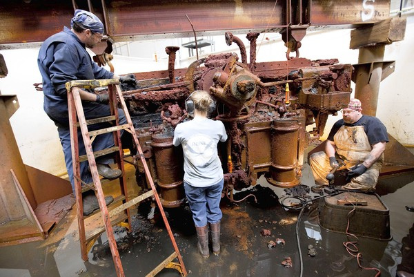

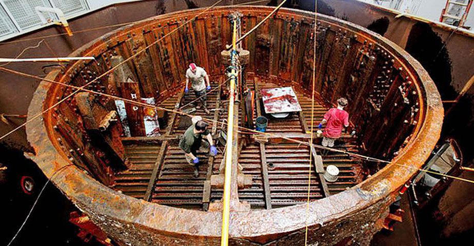

A lot depends on whether you are raising an artifact from fresh or salt water. Metal objects raised from salt water do have to be soaked in fresh water for a long time to slowly leach accumulated salt and other minerals out of the pores in the metal. Otherwise the salt will continue to destroy the metal. A good example is the raising and restoration of the USS Monitor about a dozen years ago The turret is the most identifiable object from the Monitor, followed by the engine. Here are some restoration pictures.
Mike
Raising the turret:
Restoring the turret following a long "bath":
Restoring the engine:
