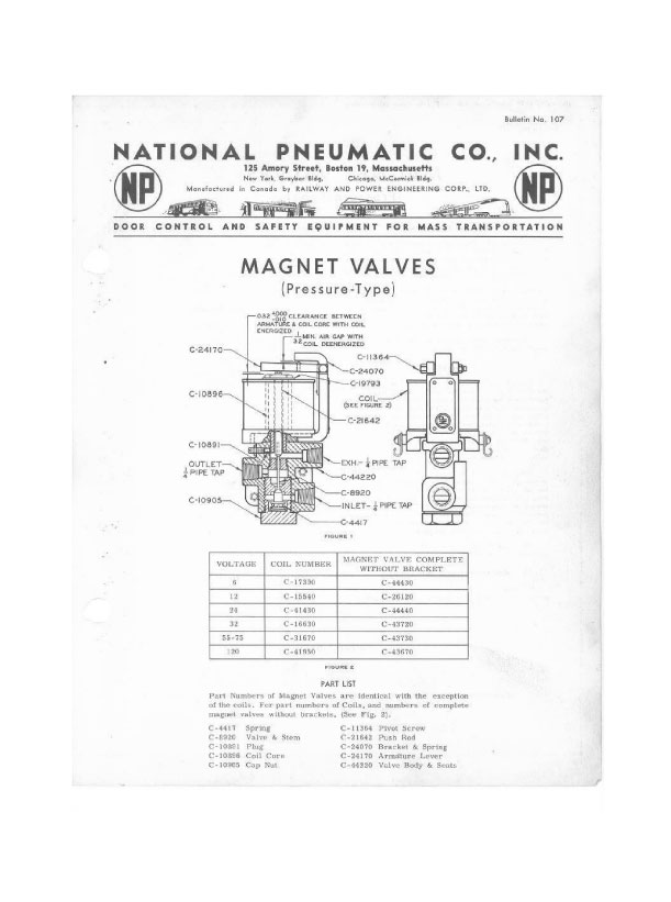

In this unit the coil is supposedly replaceable:

I *think* (and I am a bit rusty on this info) that at some point Vapor bought out National Pneumatic and then some years ago Vapor became a WABTEC Company. It's a long shot, but you might try finding "the old guy who's been here for years" at Vapor and see if they would be of any help. I don't know if those DL&W diners had sliding pocket doors or air operated swinging doors, but the old pocket doors on the 1940's and 1950's lightweight cars are similar to what is still in use on Amfleet and Superliner cars, so some parts may still be available.

You can manually rewind the coil using varnished copper wire if a replacement can't be found.

Try Graham-White. I suspect they can cross the part number over.

Vapor is now a Wabtec company. [url]
http://wabtec.com/subsidiaries/default.asp[/url]
There are two divisions.
The bus division http://vapordoors.com/index.htmlwhich handles pneumatic doors and similar hardware, and is probably where replacement coils would come from.
(Note the modern door engine on their home page - to me it suggests a National Pneumatic ancestry.)
The rail division is in Plattsburgh, NY.
http://wabtec.com/subsidiaries/locations.asp?id=66
They handle the electric door operators.
