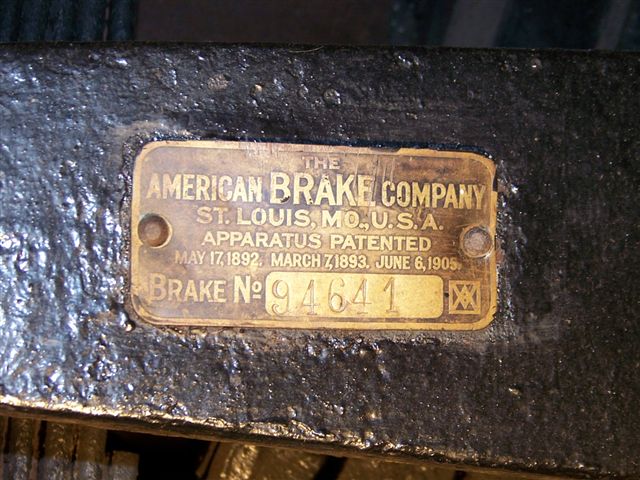

I have more information regarding the locomotive that I am researching.
Baldwin construction number: 53296
Baldwin classification number: 10-22D-94
Build date: June 1920
From the Baldwin "Specification for Locomotives" card:
"Brake, position on all driving and Tender wheels"
"Operating | Eng sch No. 6 ET [i]W[i]estg. combined auto and straight air."
"Foundation | Drivers, sch. M-1 Ameircan O. S Equalized"
Manufacturers code plate on cylinder lever on locomotive:
American Brake Company, Saint Louis, Missouri
Patended May 17,1892 Patended March 7,1893 Patended June 10,1905
Brake # 94641
Apparently American Brake Company provided the foundation brake rigging for the steam locomotives or at least the primary brake lever and fulcrum. There is very little on foundation brake rigging for air brakes in the Baldwin Locomotive Works standard practice that I have access to, but references to ABCo.
I am looking for the origional drawings for this application (BLW #53296)IF they exist. I have access to the actual locomotive so, I can see what the parts that are in use actually look like.
Thanks for the leads to all who have responded and may yet respond.
John

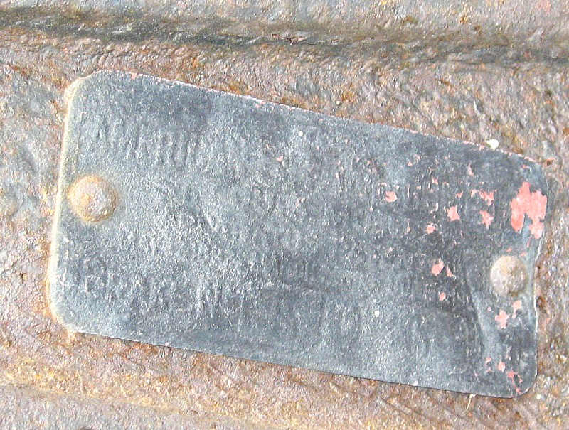

I believe this to be an American Brake Company part, its quite hard to read the tag, but figured it would be nice to add to the record. This is on CNR 1531 in Barrie, Ontario, built by Montreal Locomotive Works in August 1910 for the Canadian Northern Railway, which later became part of the CNR in 1919.

joe6167 I agree, that is an American Brake Company tag that you posted.
John
File comment: ABCo tag on #152

Interesting how there is a Westinghouse logo on that tag
