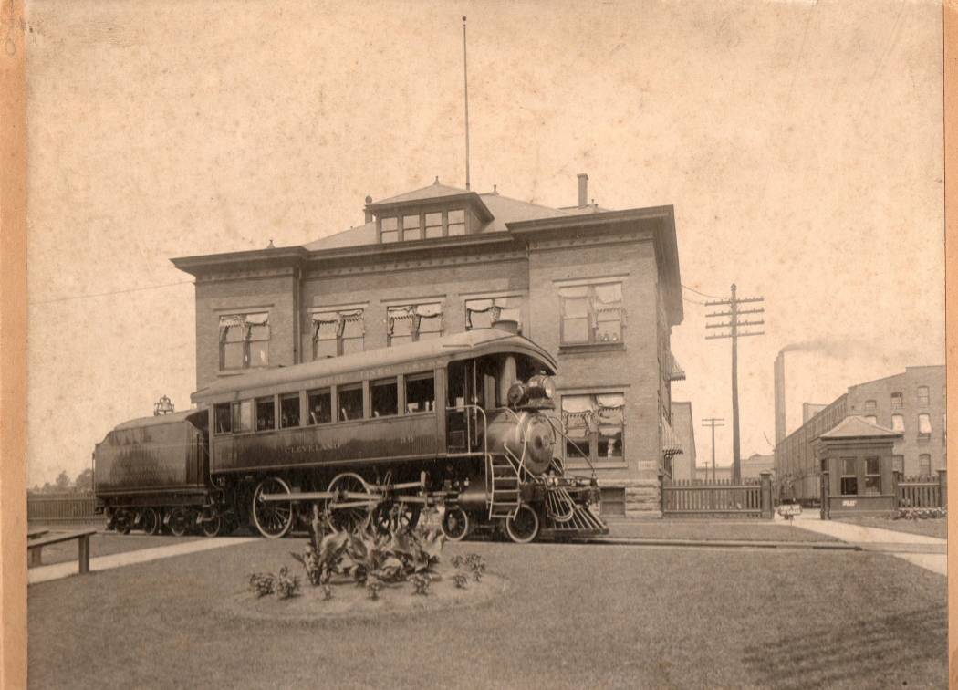

Here's a old cabinet photo i have of LS&MS/NYC inspection loco #30 "Cleveland" i believe taken at Collinwood,Ohio.The office building in front has a builders date stone of 1902 on the bottom right.Look up at the 2nd floor far right windowsill and there are what looks like 3 locomotive class lights sitting on the window sill,wonder why they are sitting there?
I see they have the bell mounted on top of the middle of the tender.Probably would have been pretty noisy if mounted on the engine for the occupants! A watchman stands by the small guard shanty in uniform and the sign in the grass to the left of the sidewalk say's "Keep off the grass".When was the last time you saw a sign posted like that anywhere!

Very cool, Ron, thanks.
Looks to me like the lifting link pivots on a tumble shaft of its own. It is less a link than a bellcrank.
