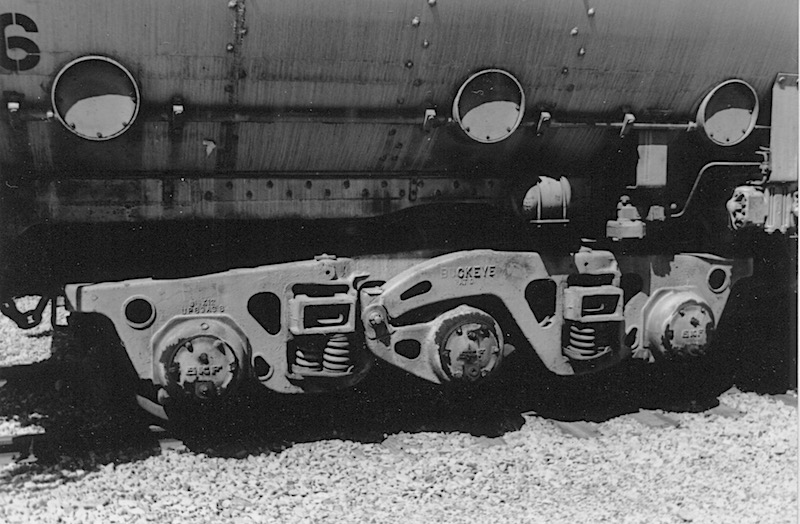

Added this Ogden Turbine Tender... 6-wheel Buckeye truck, to the conversation.
Equipped with SKF bearings. It's quite a piece of gear..
