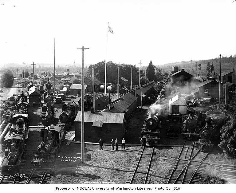

Here is a photo, could it be one of these at that late date? The caption where I found the photo reads: "This is a photo of the Polson Brothers Logging Co. out of Hoquiem, Wa. This pic was taken in 1940. The Line was started in the 1880's. The company was bought out in the 1950's by Rayonier Inc, who operated it until the the late 1960's."
 Post subject: Re: UP Steam Puzzle
PostPosted: Sat May 25, 2019 4:34 pm
Posts: 1270
I have always loved that photo and the #10 is probably there. It was scrapped in 1955. Almost everything in the caption is wrong.
"This is a photo of the Polson Brothers Logging Co. out of Hoquiem, Wa."
Polson Brothers became Polson Logging Co. in 1903.
"The Line was started in the 1880's."
Polson started railroad logging in 1896.
"The company was bought out in the 1950's by Rayonier Inc, who operated it until the the late 1960's."
Rayonier bought Polson in 1948 and used the railroad until 1984.
