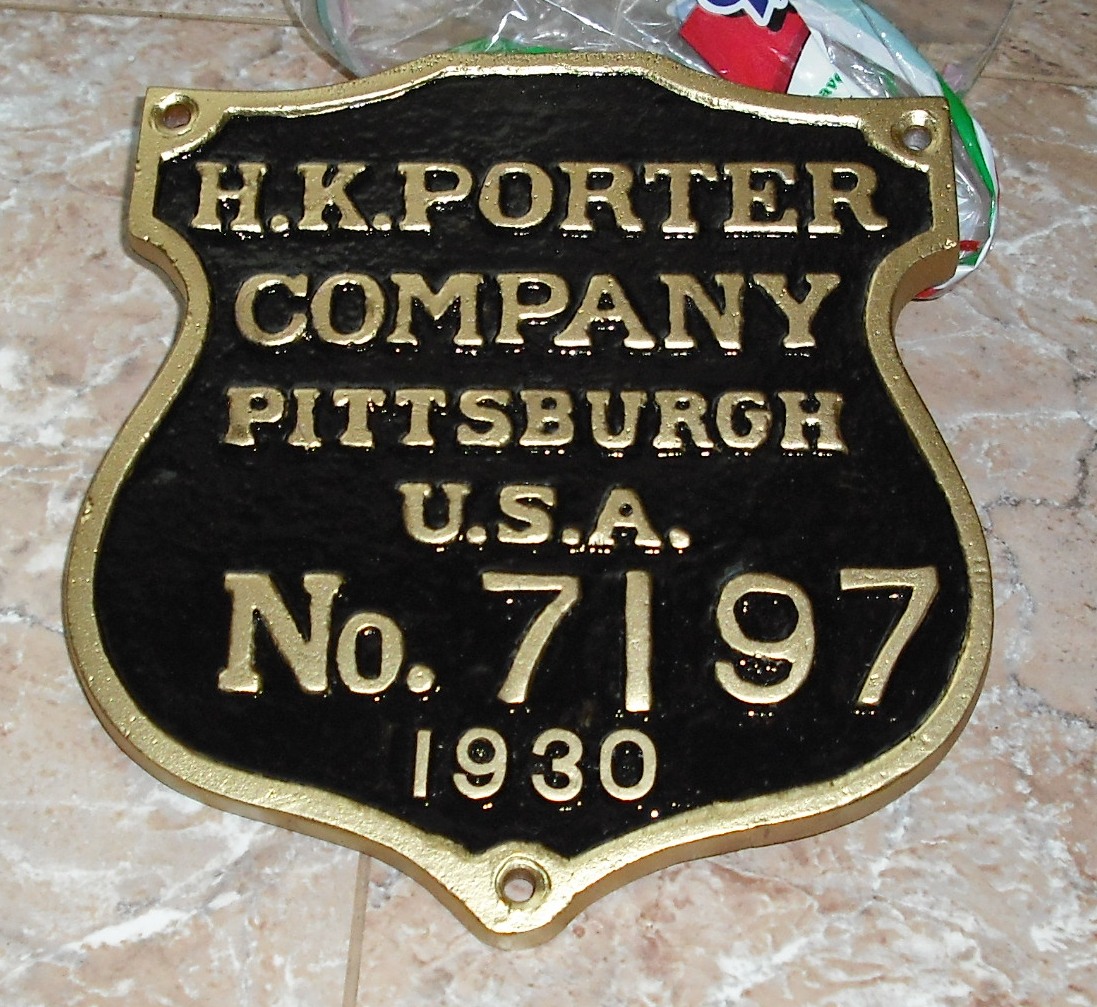

For my Porter I used a guy in Ohio who made aluminum reproductions. They were very inexpensive but did require some clean up on my part. In the end I was quite happy with them and if one was stolen it was no big deal. Send me an email to jrmay@monmouth.com and I can pass his contact information to you.
J.R.

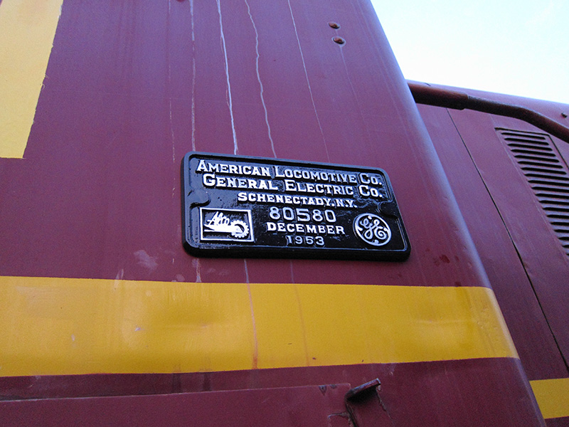

Wayne James has done some great work for me and the Rochester & Genesee Valley Railroad Museum. One of the things he did for me was reproduction ALCO builder's plates in aluminum for our three different ALCOs including ex-Lehigh Valley Railroad 'Hammerhead' RS-3m #211 shown here. The plate here is held on with magnets to allow it to be applied for special events and then removed.
-Chris Hauf
R&GVRRM on Facebook

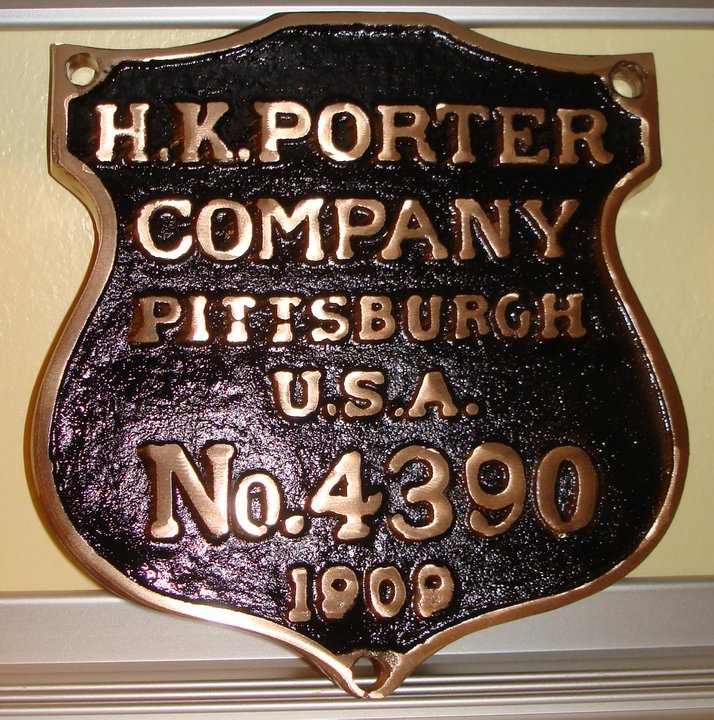

I made my own pattern for the plates for my locomotive (porter 1909). I did a resin copy of a plate, removed the date and builder's number, then added the right digits. The original I copied was not the best (I have yet to see a really great porter builder's plate, they were a budget builder after all), but the end result will be more than adequate and in keeping with what originals from the era were like. It is not difficult and I had my cast at a Portland foundry for less than $50 a piece in silicon bronze.
166366_487738488350_519153350_5748145_5311582_n.jpeg [ 171.99 KiB | Viewed 9735 times ]
Best,
Stathi

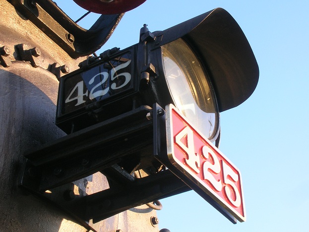

Ive also had builders plates and a number board pattern made by Wayne James. I highly recommend his work. Take a look at the Reading and Northern 425 for the finished product.
