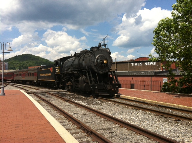

Greetings all,
Caught the 734 returning to Cumberland yesterday while travelling through Cumberland and wow, she doesn't sound good. I noticed on videos from late last year and the current year that the timing just didn't sound right, but in person it sounds even worse. Does running the locomotive in this condition long term cause extra wear or additional running gear issuses? Is there a reason they wouldn't have addressed the problem by now?
Tyler
File comment: WMSR 734 returning to Cumberland 6/3/12

Unless something has changed in the past year (almost to the day actually) this is a deteriorating condition, considering the way it is now I would highly doubt anything has in fact changed. It stems from the left side baker gear, it has an amount of lost motion and play in the gear components which is beyond that which can put words to.
Last I saw the locomotive the gear connecting rod was striking the bell crank when in forward position/motion. To the point it had actually worn into the bell crank. In walking aside the locomotive one could observe the gear connecting rod in position where it should start moving the bell crank, JUMP forward striking the bell crank.... a delay (while still moving forward), then motion and an exhaust.
I was unaware baker gear could deteriorate to this condition and, in this condition, it is in fact doing damage to the VALVE gear but not the running gear so much. To an extent the case could be made that the uneven distribution of power and resulting lack of "balance" in the loadings may be causing irregular wear and stress loadings in certain components of the running gear....though I doubt actual damage compared to that seen in the valve gear due to components striking the other none of which should ever come into contact.
If one with an experienced ear listens to the exhaust in some of the recent vids it can be heard just how bad the valve rings are, there is a constant "tone" from the exhaust with only louder blasts of exhaust....even at low speeds. Simply put, steam is roaring by the valve rings directly into the exhaust.
Both conditions do lead to a lack of efficiency in fuel and water economy.
Cheers, Jason
