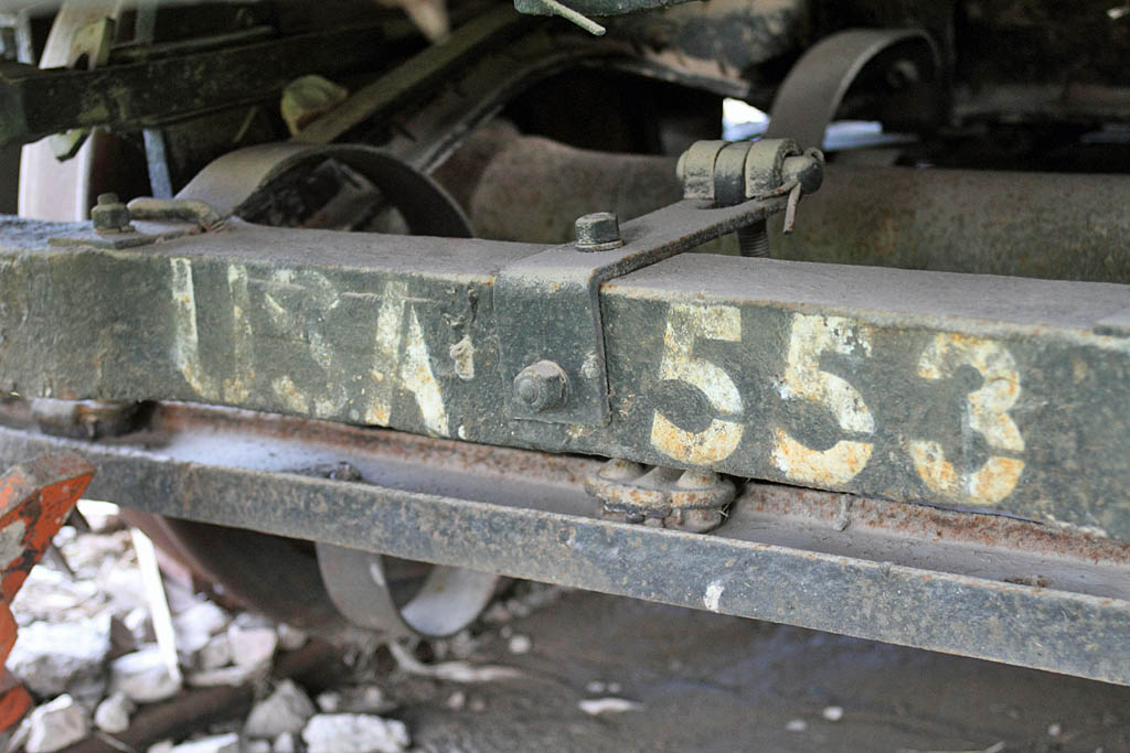

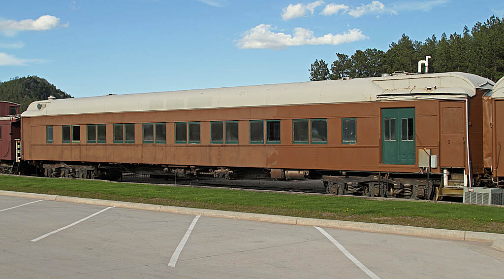

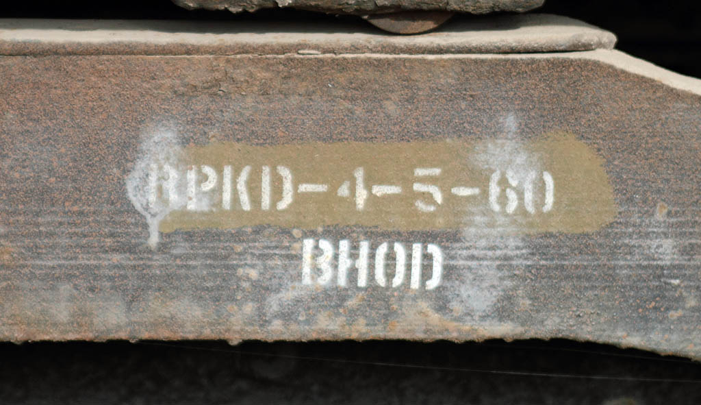

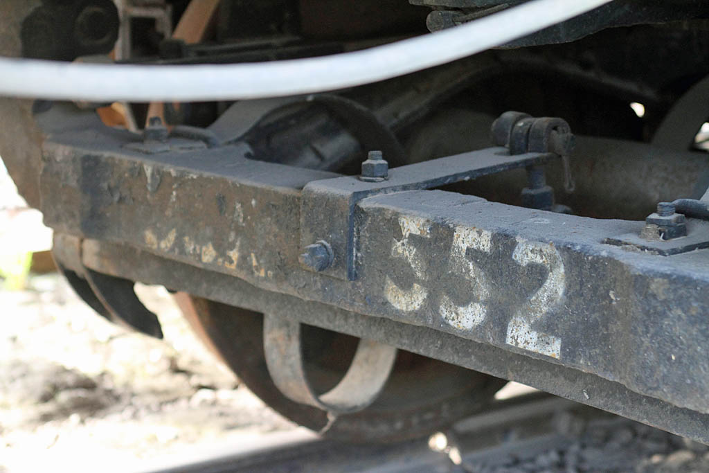

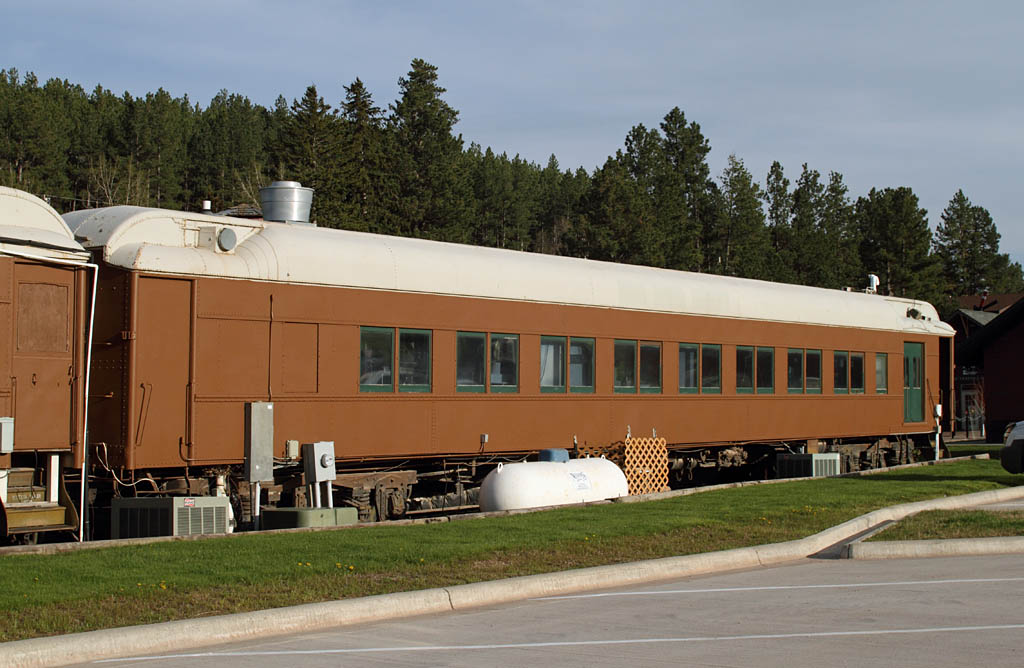

I've been trying to track down the history of the two US Army coach cars (hospital cars?) now at Hill City, South Dakota on the Black Hills Central Railroad. I've looked online for available resources (like an army rolling stock roster) without luck, and I'm not quite sure where to turn at this point. A passenger car expert I'm not! If anyone can identify what type of cars these are, or provide more info as to their history, it would be most appreciated.
What I know:
Numbers are USA 556 and 557 (numbers located on trucks; later confirmed in old photos). They were last painted in a two-tone green scheme and lettered "United States Army - Transportation Corps."
Pullman returned around 1,500 stored "gothic" cars to the rails as troop cars during WWII. Most were 12-1 and 16 section sleepers.
Both cars were acquired from the Black Hills Ordnance Depot sometime in the mid-1960s. The first photo I have that shows them at Hill City is 1967.
Last service date is 1960 at "BHOD" - Black Hills Ordnance Depot, Igloo, SD.
Both cars have end doors for loading gurneys, same as seen on similar Army hospital and mortuary cars.
Thanks!
Jeff Terry

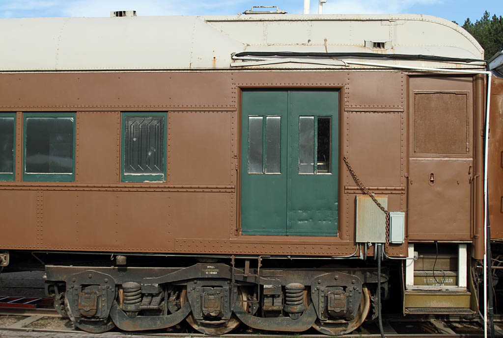

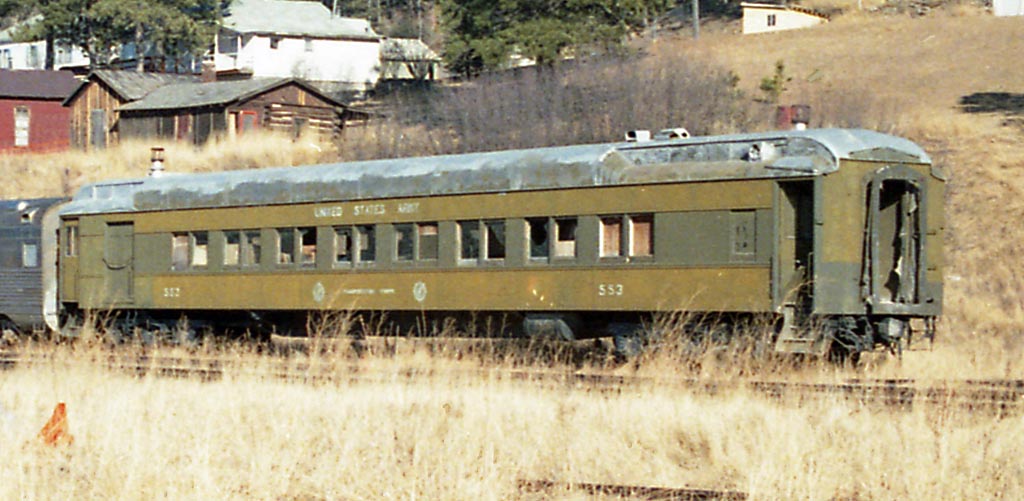

Photos taken in 2011

They are what I'd call "second-generation" Pullman sleeper heavyweights, with the heavier belt rail and the moulding over the windows (bottom of letterboard), which is post-1920 construction style. The "stepped end" construction is another mark of that style car.
If you could get a window frame loose, chances are about 99% you can identify the car-- Pullman used metal stamps to mark the wood window frames along an edge, so they'd go back into the same car after repairs/overhauls. Even wood window sills and many other parts were marked, either by stamping or by painted lettering.
These look to be in very nice shape, with little or no heavy corrosion around the vestibules. That seems to be the mark of most heavyweight Pullmans that are extant in the Northeast.
Are they parked as display cars, or are they used in train service?

Wow, a lot of great information posted here.
The cars are parked, and to my knowledge have never been used on the railroad (they are much too long for the curves on the ex-CB&Q Keystone Spur). They were used as a restaurant in the past; one of them is now a snack bar. The other housed the South Dakota State Railroad Museum until their new building was finished.
I don't believe that they were in mortuary service, as they arrived with their windows intact. (If they were used as mortuary cars, the Army would have been the one to convert them back). The attached photo, from my collection, shows 553 stored at Hill City in 1986 with its windows intact, in the configuration that it arrived in. It would appear that Bill Heckman is using it for storage.
It is impossible to get a photo of the interior that would be of any benefit. The cars were long ago gutted of any original furnishings, partitions, etc... If there was a kitchen at one time, it was removed long ago.
Jeff Terry
 Post subject: Re: US Army cars, Hill City, SD
PostPosted: Wed Jun 13, 2012 5:21 pm
Based on the wide clerestory roof visible in the 1986 photo of 553, I'd say with great certainty that it started life as a heavyweight Pullman parlor car. The sleepers had narrower clerestory sections, to better accomodate the upper berths.
Wayner's books on heavyweight Pullmans might yield some clues, especially if you start with the premise that the car was built as a parlor.

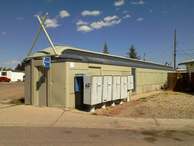

Great information thanks, as soon as i can i will get inside this one in Cheyenne perhaps we can solve this mystery too.
Mike Pannell
