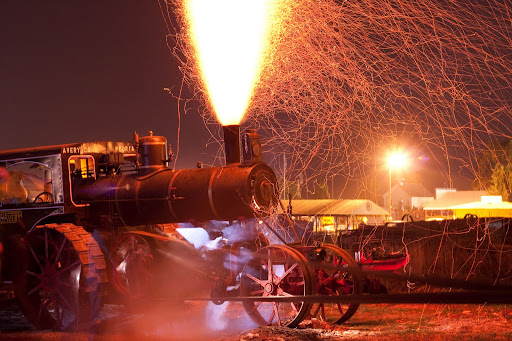

Last edited by Kelly Anderson on Tue Aug 06, 2024 10:11 pm, edited 1 time in total.
 Post subject: Re: Anyone Wanna Tell Us How This Happens?
PostPosted: Sat Aug 04, 2012 2:02 pm
thats a little more arty time lapse at night enhancing the effect.
