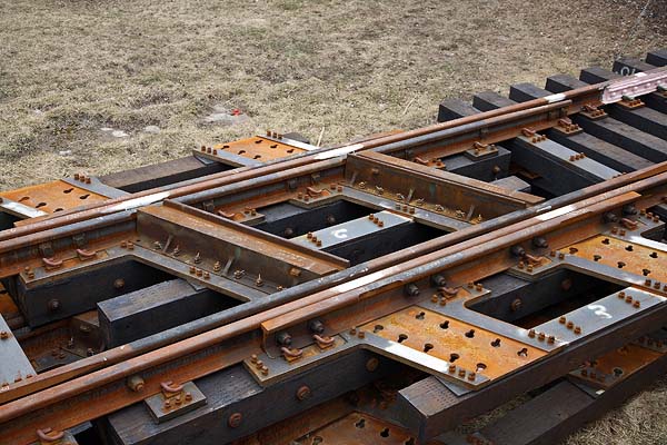

Price of a new OWLS diamond $133K CAD + installation as of a few months ago. Angle doesn't really affect the price too much unless it is extreme. Same speed both ways is about 50% more, plus much higher annual maintenance costs.
File comment: Owls Diamond
