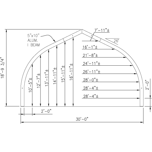

Let's forget about opinions and just look at the facts.
Here's the manufacturer's drawing for the Sprung brand structures, which is what was being discussed and also is the most common type.
To reach a clearance of 16' 11", you need to be 12 feet in from the side wall. (A total of 24 feet of width when you count both sides). That is a lot of space...
