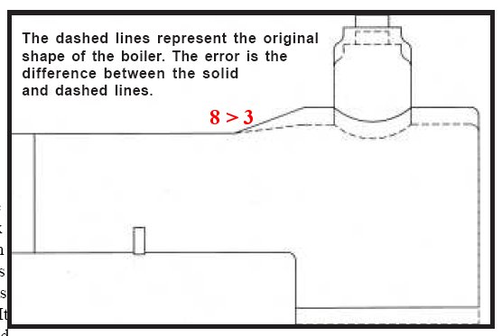

According to Mr. Dixon of Dixon Boiler Works, somewhere between the field drawings and the envelope drawings provided to DBW, the dimension of the offset of the tapered course from the barrel to the wrapper sheet morphed from a 3" to an 8". DBW generated a set of construction drawings that were provided to NSRM for verification and the construction drawings were verified against the ENVELOPE drawings but not necessarily the boiler. The boiler was constructed to the "approved by NSRM" - DBW drawings. I believe I remember Mr. Dixon saying the gentleman responsible passed away before the boiler was delivered.

I had a fuel tank that came in at 3'6" rather than 36" because a bug had died on the glass in the fax machine and left a smudge in just the wrong place when it was cleaned off. Shit happens, it's the railroad. 3 and 8 could be confused by some similar printing or typography error.
dave
