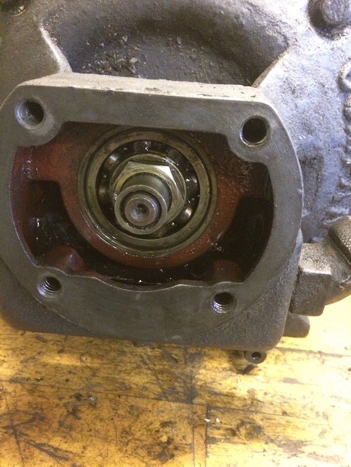

Hi everyone,

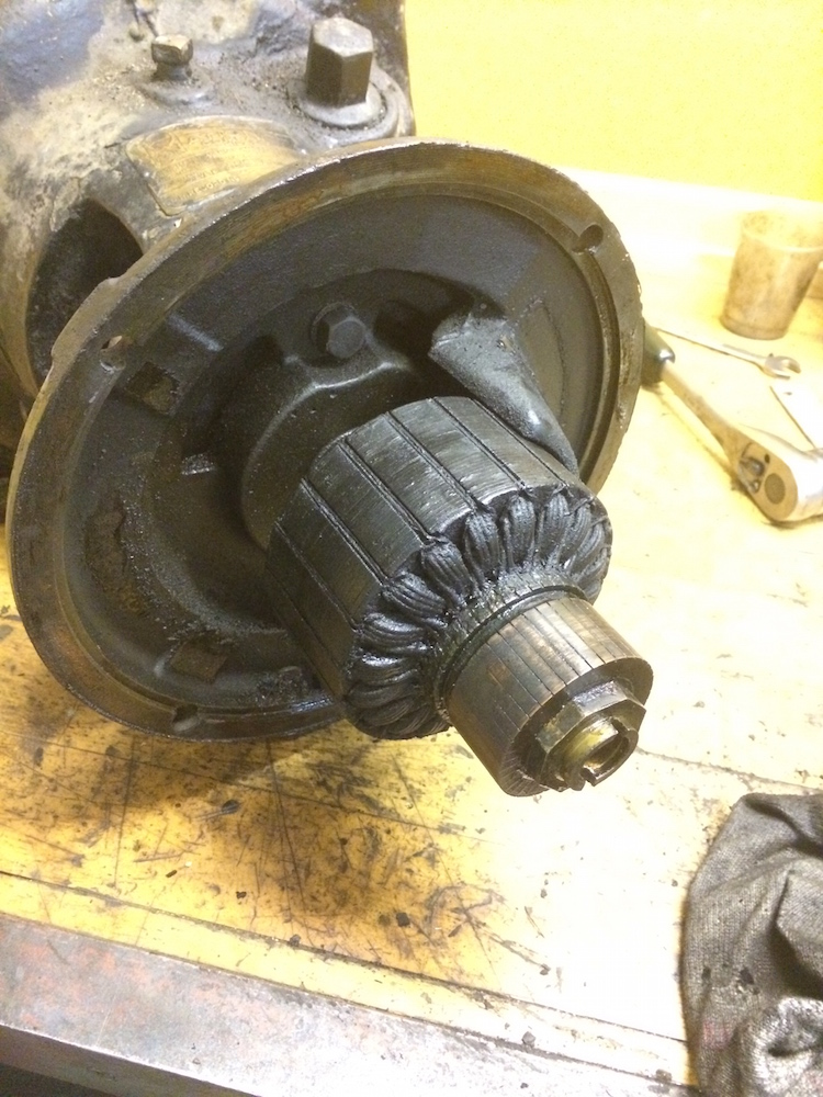

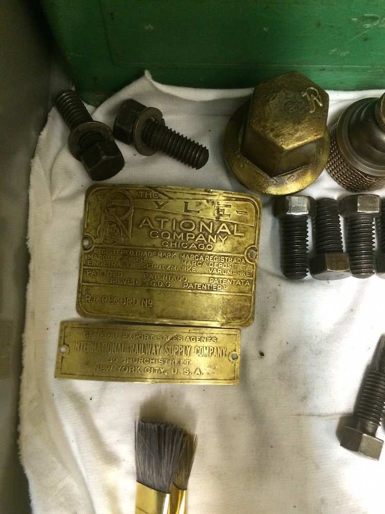

I am having difficulties with the restoration of a Pyle National K2 turbo generator. The unit is very interesting as it has an international broker plate attached beneath the original Pyle National plate, which itself features the older version of the company logo. At the time being, I am trying to remove the turbine cover.
As I understand it, to remove the cover, the bearing must come off the end of the shaft, in order to remove the casting. At the current time being, I cannot get the ball bearing nut to come off. I am to the point that I will be making a special tool that has a ridge to lock into the notch in the end of the shaft in the generator housing, so I can apply force to the shaft to undo the nut. I have already tried applying force and grabbing the shaft collars in between the two unit housings, but the collars are not tight on the shaft and it just began to spin.
The second question I have is would it be a problem if I removed the rotor assembly? I have been told that with the British Stone generators and various versions of German generators, this is an absolute no as it will corrupt the magnetic field of the unit. On the K2, the unit is very loose on the shaft and seems as if it is meant to be easily removable for maintenance and replacement. Would that be an issue?
File comment: bearing lock nut inside the turbine cover casting

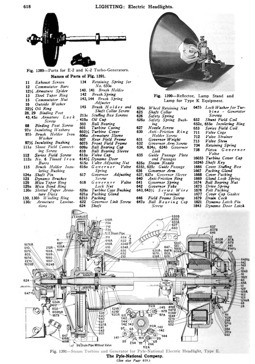

File comment: The drawing is for an E2 generator, but the shaft, rotor, and turbine wheel are the same

No, the bearing does not have to come off the end of the shaft by removing the nut. There's a spring loaded device that sort of snaps the sleeve on the bearing assembly onto a keyway in the main shaft. If it's been there a very long time, try a lot of penetrating oil followed by prying from opposite sides (180 degrees apart) of the cover simultaneously against the main body.
Once the splined drive washer is off the armature end, just pull the damn thing off and don't worry about phantom magnetic fields. These are pretty robust and idiot resistant, patch in the field machines.

What both of these guys said, and a very positive recommendation for Bernie Watts. One of the reasons for the the bearing to be mounted in this manner with the spring clip on the sleeve, is that one has to remove the end housing in order to adjust the governor screws which pass through the turbine wheel and have square heads. Normally to remove the end cover there is no need to remove the bearing oil res. cap. One just pulls the hole end plate bearing, oil and all off keeping it level when setting it aside, when you are making governor adjustments. One may have to make this off/on procedure several times to get the speed/volts right. You may find as I did on one a couple years back that the governor mechanism is badly worn. Bernie has all of the parts and at what I thought was a reasonable price.

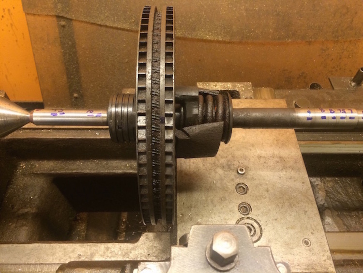

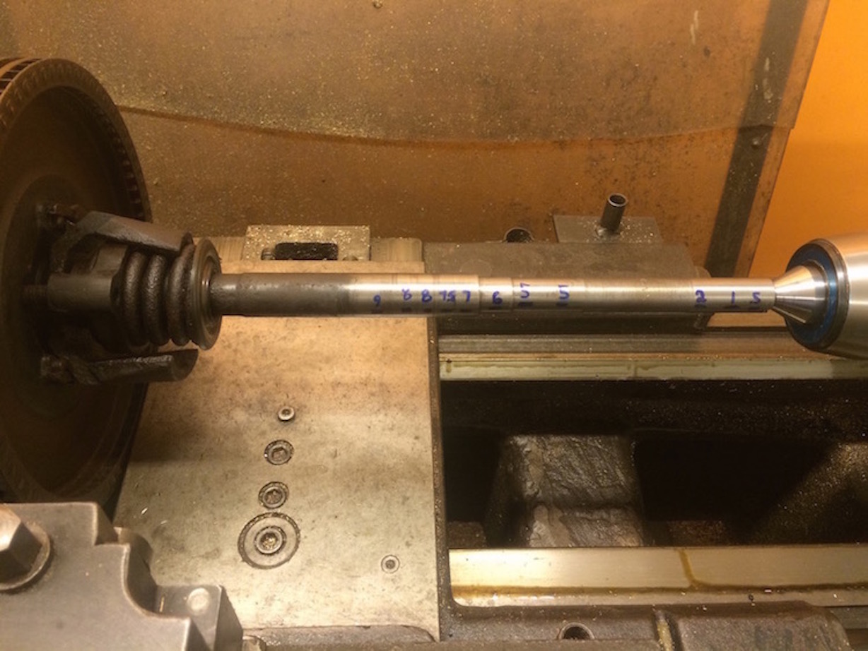

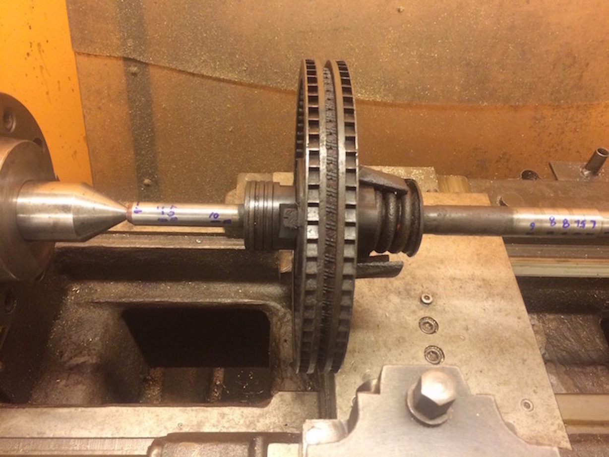

So after having gone through many of the parts and being fully under way with the restoration, I've determined that the shaft of the unit is bent at the turbine wheel. The shaft swings around 3 thousandths of an inch when held between centers (markings are hundredths of a millimeter). In the photos the shaft is bending away from the camera. Is this within the acceptable tolerances for the unit? It was known that one of the two units we have had a bent shaft, it just wasn't known which one till now. When I slowly test ran the unit with the shaft still in the bearings, I got a much smaller reading of swing on the generator end.
Hoping to find an answer here before contacting Bernie Watts
Also Dick I did not see your email but I am definitely interested in this operating manual you have!
Also for everyone out there, this unit is not needed at the time being. I am slowly going through parts we have in the storage wagons and restoring them in my spare time (extra days in the shop). The condition of both units is unknown (now a little less so), so I intended to go through the entire unit to see what I had and figure out any repairs necessary.
Thanks in advance everyone!

Check the runout at the armature - I don't think .003 is going to be an issue at the turbine wheel, but if it throws the armature off, the brushes will bounce rather than seat, with unfortunate results. Of course, if you know where the high spot is, you could simply gently tweak it back into straight.

N&W Historical Society (https://www.nwhs.org/archivesdb/) has drawings for the a K-2 shaft (NW-C331500), case packing (NW-C33121), and turbine cover packing (NW-B33148). I have copies, but their prices are reasonable and their service is quick so please contact them for copies.
On the shaft drawing it looks like the area on the right that you marked has a plus or minus .0005" tolerance. The one on the left is plus .0000", minus .0005".

I rebuilt one for SVRy a couple seasons ago. I made a short shaft to pass through the armature to mount it for turning the commutator. When I reassembled it to the dynamo shaft I checked run out, it had a bit more than I was comfortable with, so rechecked the armature by mounting in the lathe again, also having rechecked my temp. shaft. All was well there, and the dynamo shaft seemed pretty good as well, but not so good with the armature mounted. After a little fussing around, I reinstalled the armature 180 deg. around and wallah, all was better and quite acceptable, probably proving the original mfg. tolerances were not that tight.

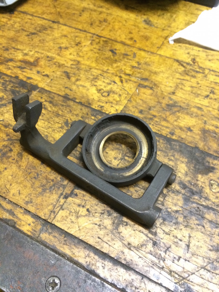

Has anyone come to the point where the frictionless element needed replacement? I am tempted to clean out all of the carbon remains and epoxy glue a Teflon disk into its place. I figure that way I can keep the original unit with the governor regulator and slightly modernize the unit.
Might possibly create two Teflon screws to mount the pad to the unit and let them be worn away.....?

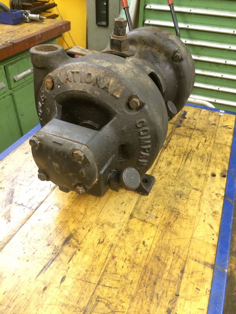

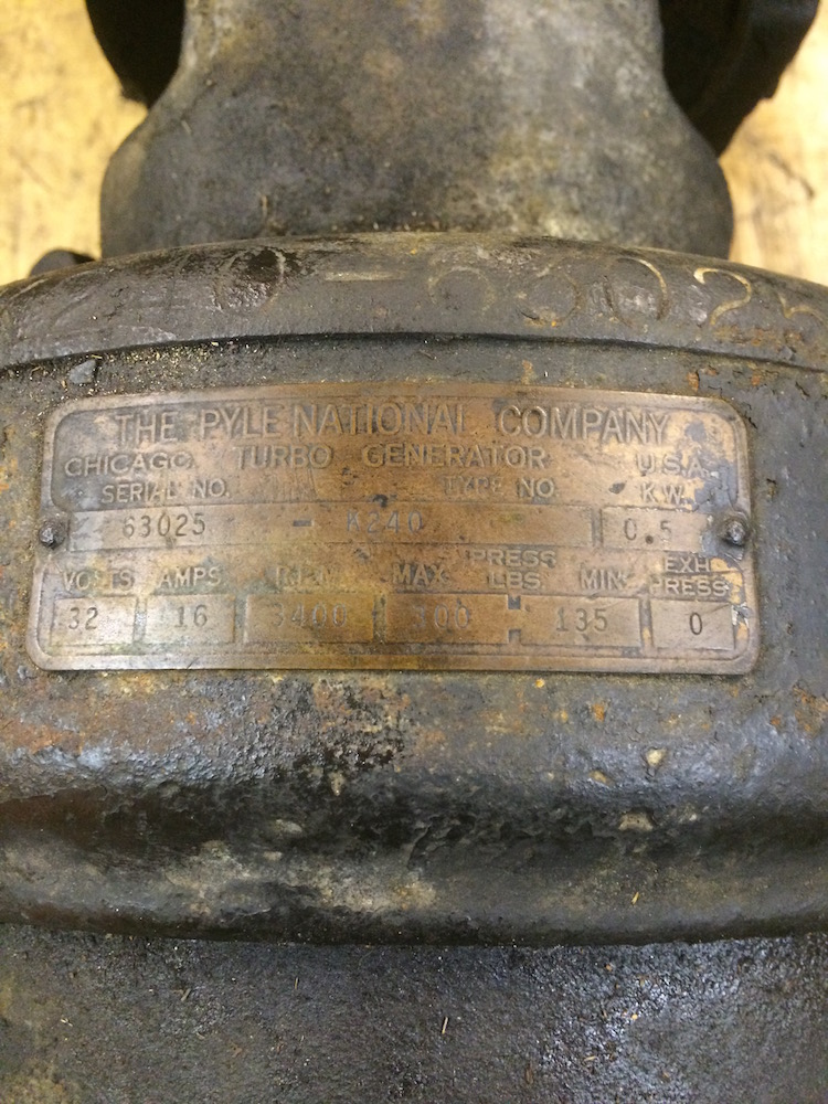

Also for the sake of history, does anyone know when Pyle changed the identification tag from the large and elaborate square to the small rectangular tag? I had the other unit out today to start evaluating the work needed on it. It looks to be like a serious basket case around some areas.......
