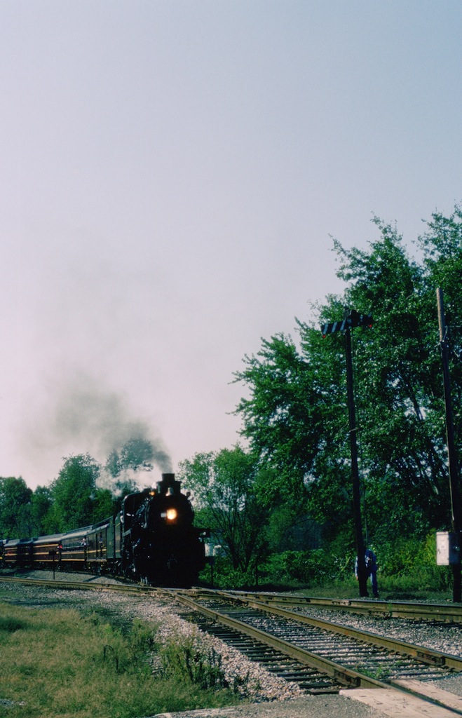

The signal you are thinking of on the former Ohio Central is at Justus, OH, near Brewster, where the now G&W crosses the R J Corman line from Warwick Jct. to Dover, OH, part of the former CL&W sub of the B&O. The signal there is not a ball signal, it's a tilting arm on a pole that indicates which line has the right of way. See attached photo of 1293 preparing to cross the diamond in Sept. of '08.

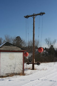

Here are some picture I took of the signal back in 2005. I hope I have got size right. There was alot of things in that area at the time even a snow plough.
