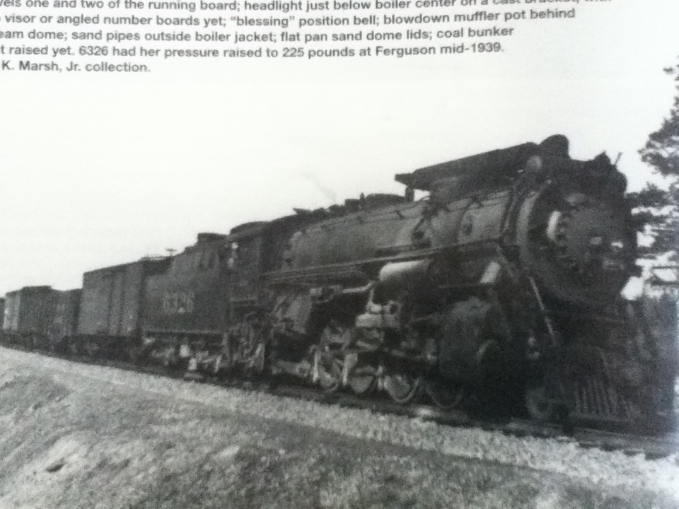

Does anyone know what the serial numbers were on the Southern Railway Ms 4's builders plates (CNO&TP #6320-6337), built in 1926 by the ALCO Richmond Locomotive works? Secondly, does anyone know where I can find the builders blueprints for this particular series of locomotives? I have checked with ALCO historical society and the SRHA (which I am a member of). Unfortunately I sent a message to the SRHA 4 months ago and still have yet to get a response (by the way what is the address of the SRHA? I got my address from a 1998 Ties issue). Also which Super Heater Company had their plate on the smoke box? If possible could I also get the dimensions of the super heater plate? If anyone has any sources of information, photographs, and videos of ANY of the Ms 4's that would be greatly appreciated. All of this will be added to two whole years spent researching the class for the sake of building an accurate 3/4'' Live Steam locomotive. If anyone is curious I plan to build a model of the 6326.
- Thanks for any help and information anyone can give me,
Stuart T. Harrod

As for the Southern Ms-4's their starting serial numbers , starting with engine , # 6320 were 66834 through 66851 ending with engine # 6337 . If you can find the book , Southern Railway System Steam Locomotives and Boats by R.E. Prince , their is a lot of information , including blueprints . I hope this is of help to you Pat.
