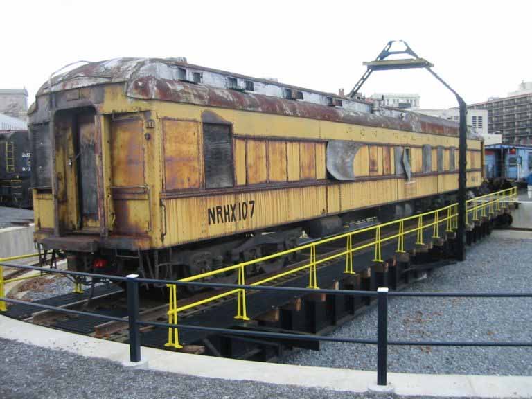

The Horseshoe Curve Chapter of the National Railway Historical Society has created a restoration committee for their former Union League Club sleeping car. The Chapter located in Altoona, PA is seeking information such as blueprints, consists the car was used in, etc. The details on the restoration are in the planning stages. There are no set time tables. As the car sits, it looks rough due to surface rust, however the car is surprisingly in sound condition with a few minor body repairs needing made due to mother nature. Please ask questions and we will best to our ability try and answer them in a timely manor. Remember the project is in the planning stages so suggestions and ideas are welcomed. Thank you.

I would start by telling us what you already have access to, drawings/etc.-wise, so we don't swamp you with the likes of 200 copies of the same diagram drawing or photos from some popular book or two.
Are parts, fixtures, etc. needed? I may know of a potential donor car out there, not of the same class but similar vintage.....

We do not have any drawings. We are looking for donor parts. Lighting fixtures, seating, vestibule doors, window frames, and what ever else may come up with future feeds. I understand posts may become repetitive, but that's okay we're grateful for your willingness.

Union League Club looks to be in decent shape; it should clean up nicely and be a great display car. Good luck with it!
