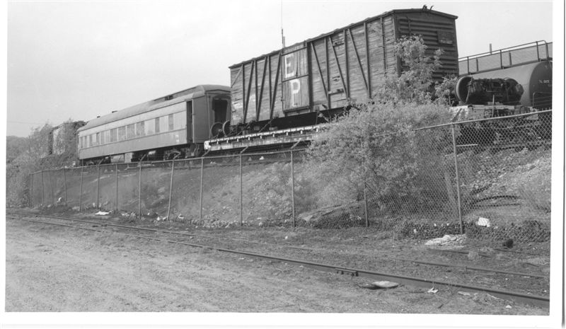

CNJ 18049 loaded on a TTX flat, enroute from Saybrook, Conn. to Scranton, at Palmer, Mass. on May 24, 1995. The Pullman "Arsenal Tower" is in between the CNJ load and a DL&W 36-ft boxcar on a second TTX flat. The DL&W car is now restored and on display at Steamtown NHS.
Further on Dennis' comments, there are also good drawings of the doors in both the Car Builders Cycs, and in relevant ICS books. The car lumber cross-sections are also in the Cycs.
