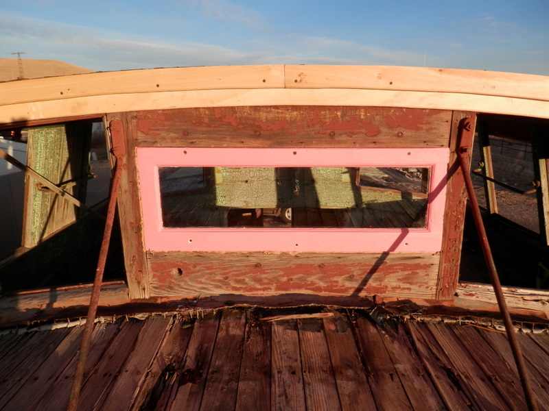

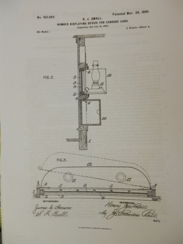

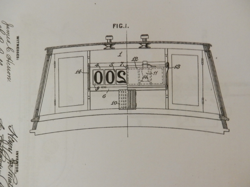

Today after many many hours of restoration the two number board windows were re-installed in the cupola, these were far more interesting than they sound at one time. They housed a complex reflector case with oil lamps and stencil plates for displaying the train numbers, thanks to helpful researchers we have found these amazing patent drawings from 1899 showing the number board arrangement.
I wasnt sure if these were ever used as photos are very very scarce but whilst installing the window this afternoon found fragments of the milk glass from behind the stencil plate. I intend to replicate the entire contraption so that we can shine train numbers out at night.
Mike Pannell
Caboose 2516

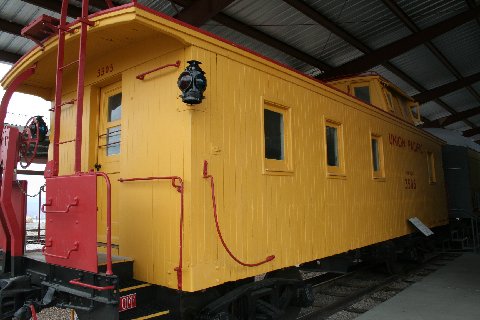

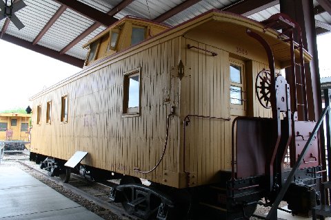

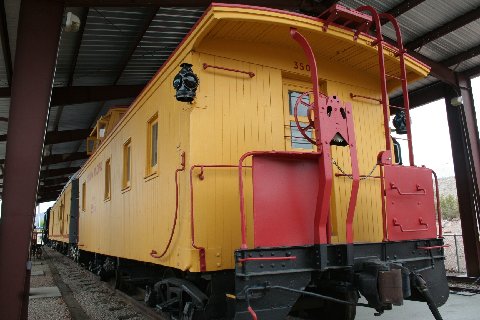

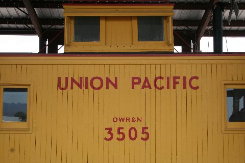

Although this doesn't have anything to do with the number boards... .Thought you might find these pictures of this UP cab over in Boulder City NV interesting... Not too sure if this is the same class as the caboose you are working on, but thought you and some others would find it interesting....
Dean Levin

 Post subject: Re: Caboose 2516 number boards
PostPosted: Thu Nov 22, 2012 10:10 pm
Posts: 429
one more
PostPosted: Thu Nov 22, 2012 10:53 pm
Posts: 825
Location: cheyenne
Excellent replies and photos thankyou all, Interior shots of 3505 would be great she is truly rare and dates from 1882 not retired until 1962, 15 years after 2516 who is 31 years younger !
Mike Pannell
