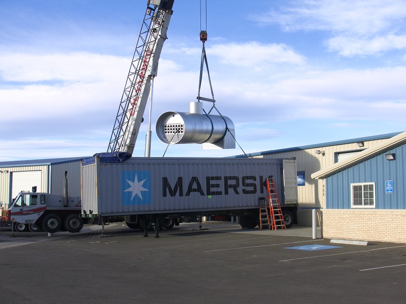

What you are about to see is the first of many boilers that will be leaving Wasatch for a far off destination. It is CRITICAL to note that these boilers are NOT 100% complete, they are NOT built to the ASME Code, they are NOT built to any US standard, they were built to another "Nationally Recognized Construction Standard."
This boiler was commissioned on June 15, 2012 and was finished on October 1, 2012. Our shop ran two daily shifts, starting at 7:00 a.m. and ending at 1:00 a.m. to complete this boiler. The second is due out in a short period of time.

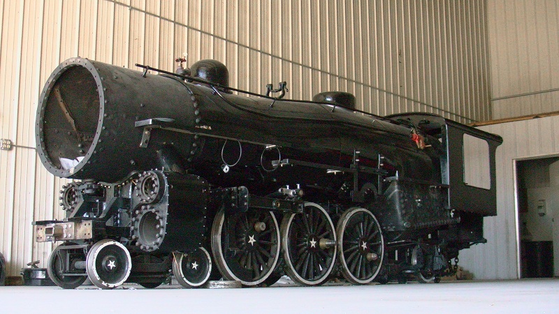

Additionally, in the next two weeks, WRC will turn out as many as twelve miniature boilers from 7 1/2 inch gauge to 42 inch gauge. Recently, the Swanton Pacific No. 1913 was returned home and is in the process of being assembled for operation.
Again, we appreciate your understanding that beyond what I have shared here, we are limited in any further discussion. We hope you enjoy the photos!

The Swanton engine is a beauty. What gauge is she? Not too wild about the huge cab window, but the rest of her looks great.
 Post subject: Re: Wasatch Updates
PostPosted: Tue Oct 30, 2012 4:38 pm
The Swanton/ MacDermott engines are 19 inch gauge.

John, nice shot of the 1913. Mr. McDermott new how to design some nice 1/3 size SP Pacifics. Sure will be nice to see the 1500 plus 3 of the 4 Pacifics side by side and hopefully all under steam at the same time.
Are you at liberty to comment on any of the 12" gauge power you have been working on?

Interesting New Boiler. Some questions about the boiler construction?
Are staybolts fillet welded? Is this boiler constucted with a square bar mud ring? Or what type of mud ring construction and connects were used.
Is inside firebox square corner or flanged?
I cannot see any flexable staybolts in the breaking zones does the boiler have flexable staybolts?
I realize this boiler in probably going overseas and not necessary has to be constucted to ASME or FRA rules.
Thank you for your replies

You must have a great monitor, Dennis. I can't make out any detail in the photo on mine. I'm always interested in learning how things can be done in new ways for various circumstances, interested in whatever John wants to share.

Now that you mention it, a second look at that boiler also shows no stays visible in the course in front of the firebox. That implies no combustion chamber. Unusual for a modern boiler. Actually looks kind of "old school".

In my first post I mentioned that the boiler is NOT finished and that it is NOT built to the ASME code. Further, beyond those two facts, there is not too much I can say.
Indeed, Dennis, there are items that you would expect to see that are missing or "not finished" Further, as I look at the photo in detail, I do not see any washout holes, outlets or other fixtures on the boiler.
You have no idea how badly I want to tell you about the stay bolt attachment but, I cannot for the time being. You could almost make assumptions: If it is not ASME, it then could include almost any form of stay bolt attachment.....right?
To the comment about a combustion chamber, the boiler is built to original designs and sizes and specifications. The word "old school" was used. Yes, this is a very old design, on a very "new" locomotive bed. The age of these units is "new" in comparison to what we know here in the States, however, the design is not new by any stretch.
I see a bunch of other stuff on the boiler that is either missing or, as I said, NOT FINISHED.
There is a lot of field finish and fit up left to be done on this unit. You will get to see more in the near future.
