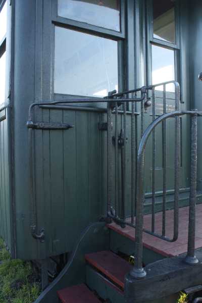

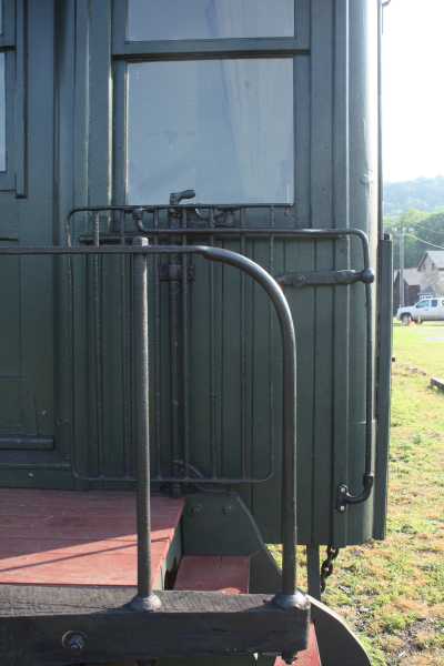

The style of gates in the flyer for which Brian Norden provided a link are still in service on the East Broad Top Railroad, on cars 14, 15, and (I think) 8. A nifty design, though it takes some head scratching to imagine the movement if you don't have one in front of you.
Here are #15's gates in both positions:
