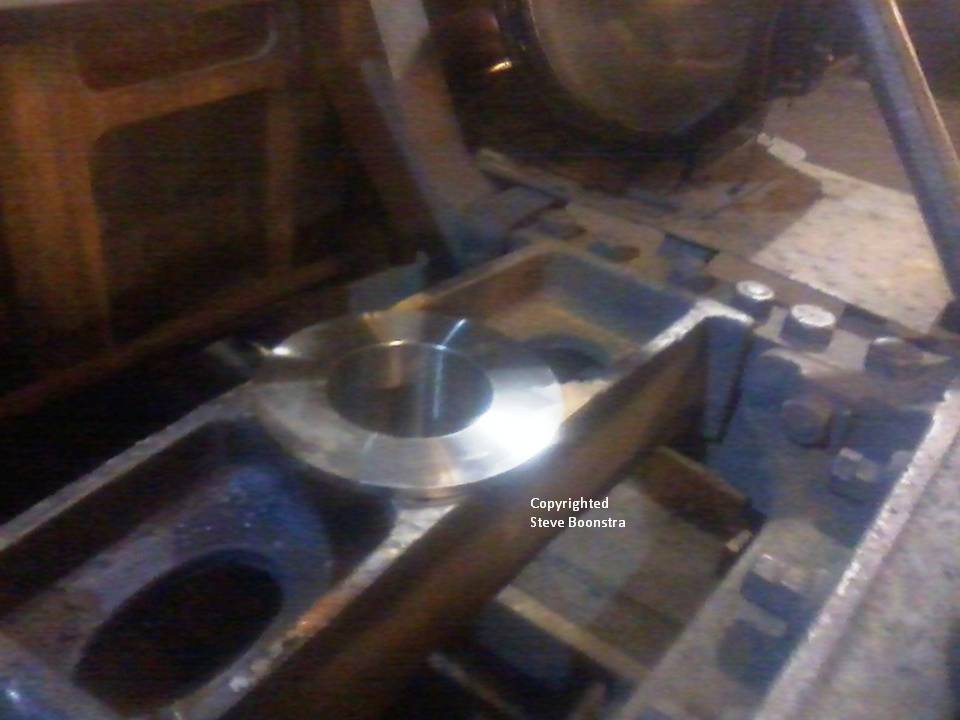

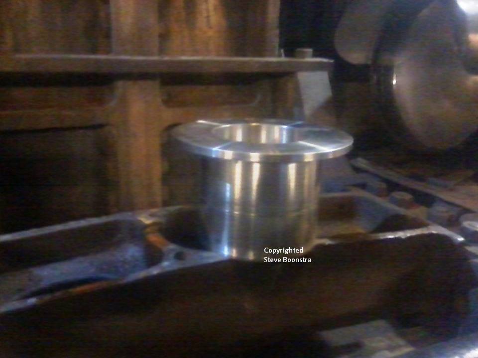

Mike, Jeremy and Brendan made the bushing for the center pin that needs to be installed in the frame for the pilot truck. It was made from raw stock of 12" round and about 9" inches thick.

Thanks Rich. Here are the pics of the new bushing! I will get Dan to take some pics of the crosstie completed.

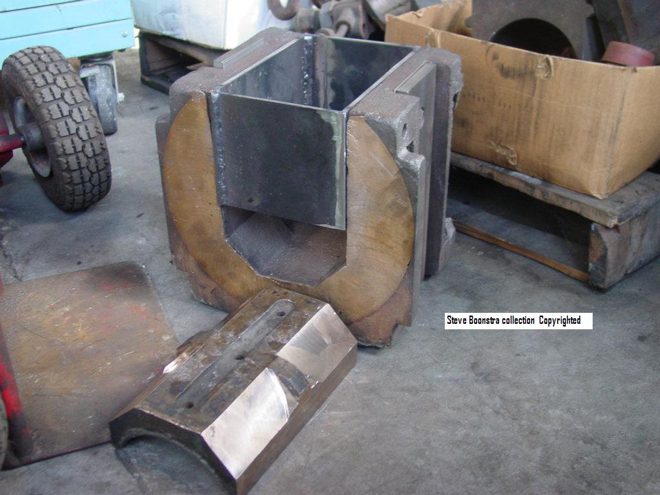

Work continues on the pilot turck for DL&W 565. We began work on the crown brass and the grease boxes yesterday. The journal boxes are shimmed to fit the frame and just need some cleaning up at the contact points, polishing.
What's left:
Need to make a center pin
Finish up the grease boxes
Finish working the brass to fit the boxes
Polish the brass where it makes contact with the axle
Then assembly of the whole thing.
Once we get everything assembled then we can check our clearance between the wheels and the journal boxes. We know we have to install brass there but not sure what our final clearances are going to be.

Thursday work day. We got the grease boxes welded up and the pins made for it. Nic is having too much fun with the welding! I finished up the last of the journal brass and milled the top part of the journal box out to accept the springs. Nic has some pics of the final product. We are getting closer to putting the pilot together. Next month I would like to have 2 work sessions and maybe just maybe we can do an initial fit of the pilot truck parts. if we get enough folks up to help we can knock this out. Let me know if you are interested in next month. Thanks
