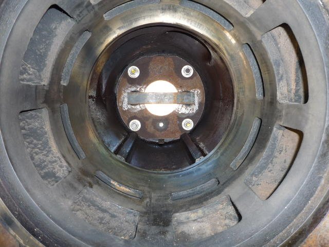

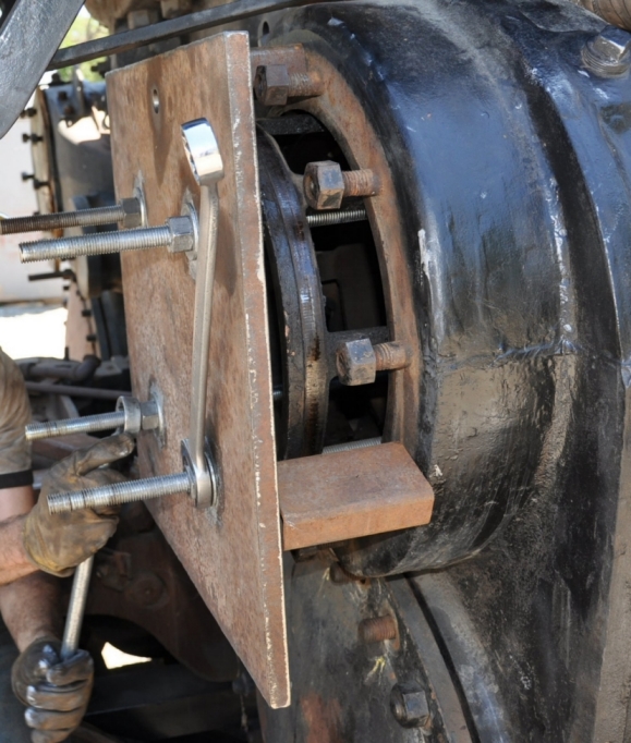

Location: San Jose, CA
SP2479 crew removed the left front valve bushing using heavy plate and all-thread. Rear plate was cut to fit at back of cage and reinforced with a piece of 1" x 2" bar stock. A section of rectangular steel tubing was cut to fit between back plate and a section of 1"x2" attached to studs that retain valve cover. This was used to push on rear plate while simultaneously pulling on front plate. All-thread holes were positioned as close to edge of plate as possible. Some machining effort was required, but removal of cage took about an hour. No damage to cage or valve wall.
We may be slow but be get the job done.
Thanks guys, those two methods combined worked great! A number of passes with the MIG machine around the i.d. and they slid out with the four bolt puller. More than one way to skin a cat!
