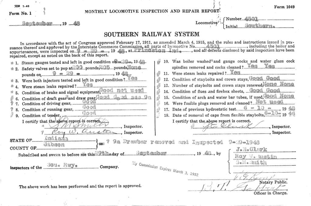

It may seem odd to resurrect an old thread such as this one but the revitalization of 4501 has also lead to the rediscovery of some old records.
This is the last monthly report filed for 4501 prior to its sale to the K&T Railroad. Please note the location - Princeton, IN. DPM was right, sorry JAC!
More later.
G. Mark Ray - TVRM

What is the meaning of the footnote marks next to the questions (* # ? ) ?

Does this document survive because it went with the engine to the K&T? On pgs. 22 & 24, DPM quotes a former SR official about some young whippersnapper junking all his old records.
Steve
 Post subject: Re: Old 4501 photos?
PostPosted: Wed Jan 30, 2013 11:06 am
Posts: 382
There are typed notes on the left side of the form that did not make into the jpg. They appear to read -
# Test as required by rule 1 and 22 made while boiler was under hydrostatic pressure.
# Hammer test applied to main reservoir.
There isn't anything to explain the "?".
This last monthly inspection form is one record that was attached to a series of records that include the final monthly inspection, the last annual inspection, the last air brake inspection, a record of boiler inspection from 1941 to 1948 and a record locomotive maintenance from 1935 to 1948. These records probably went to the K&T with the purchase of the locomotive (it would make sense for the shop at Princeton to have them) and that is how they survived. The K&T did not add to them as I presume they had their own record keeping system.
