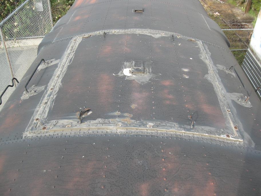

I am working on a lightweight coach with a roof hatch to allow access to the AC evaporator. I want to re-seal it to keep the rain out. To clarify, I do not want to simply apply some goop – like Henry's Roof Repair Cement – around the outside perimeter as seen in the photo. I have removed all of the cap screws that hold the roof hatch in place, and lifted the hatch up a few inches. I now want to apply some new sealant underneath the perimeter of the hatch. This is how the RR and the Carbuilder did it.
I can't tell exactly what was used previously to seal the hatch, but it looks like it was two layers of ¼" thick x 2" wide sealing tape of some sort, with burlap (!) at the top and at the bottom. The stuff I have used previously for this type of thing was self-adhering cork insulation tape that is normally used on hot or cold pipes to keep condensation from forming. It worked real well. But naturally, the product I used in the past isn't made anymore. I have done the usual Google searches, but that gets tedious real fast. So far, butyl rubber self-adhering sealing tape, 1/8" think x 2' wide, may be the closest thing I've found to what I am looking for. I will have to use 3 or 4 layers of that, as I need to get a thickness of 3/8" to ½" thick to do the job.
Does anyone in the RYPN Nation have any other ideas for this situation that have worked well for them in the recent past?

Try this:
http://www.kflexusa.com/HomePages/Produ ... 36&line=12
Or, from Grainger: http://www.grainger.com/Grainger/DIVERSITECH-Tape-2YJ69
I do know that the HVAC supply houses I deal with stock both a closed-cell foam pipe tape, and the sticky cork-based stuff.

You may want to check out the motor home supply stores like Camping World. I just bought a roll of aluminum backed adhesive tape 4"x 50' for my rv. Made by dicore products www.dicor.com. It is called DiSeal . -32 to 110F.
Not cheap but forms well around blots and screws if not too high. About $1+/foot. It really sticks, not sure how to remove it though.
