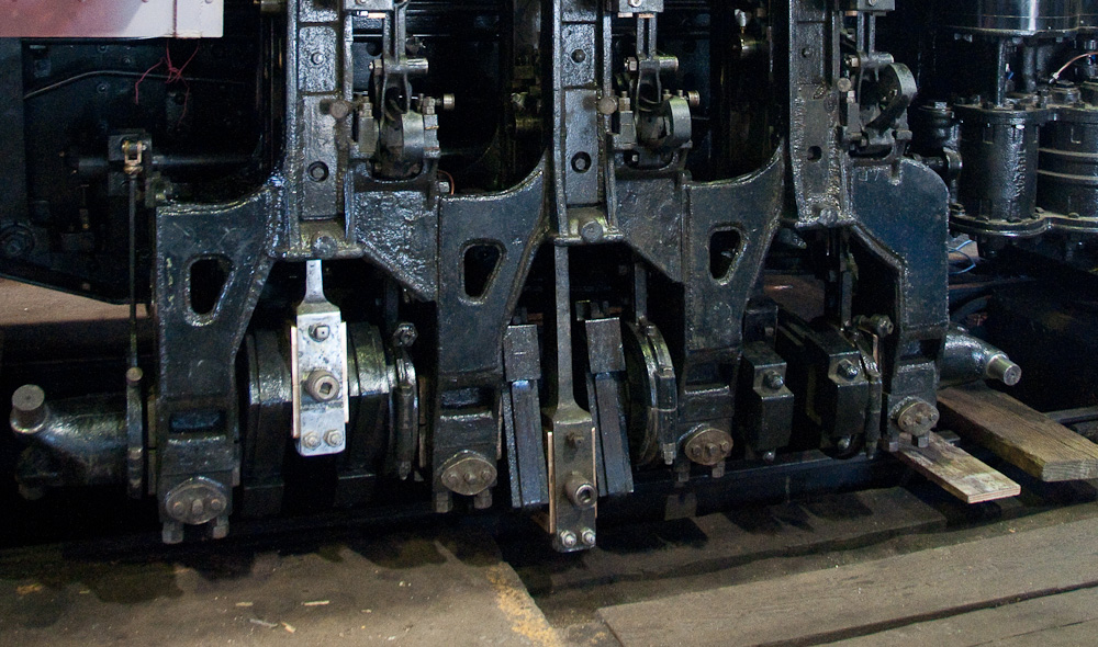

This is actually a Willamette, not a Shay, but they both work the same way. The "quartering" is done on the drive shaft not the wheels. It's very similar to the crankshaft in an internal combustion engine.
In order to make the power as smooth as possible, Shay and Willamette (Essentially a Shay clone) use a crankshaft with 120 degree offsets for each cylinder.
I would expect that all three cylinder engines do this for the same reasons.
