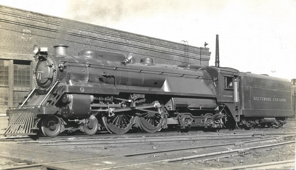

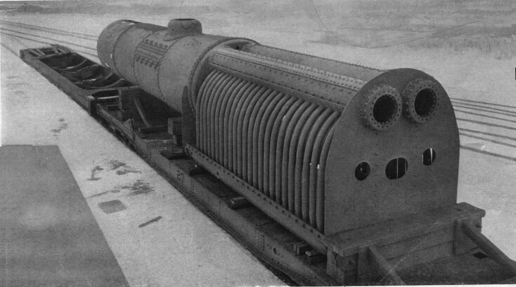

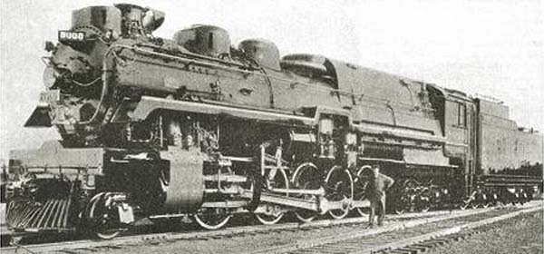

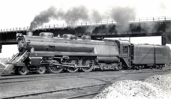

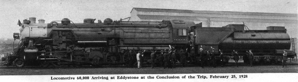

B&O had the 4-6-4 Lord Baltimore,4-4-4 Lady Baltimore and the 4-4-4-4 George H. Emerson all with water tube fireboxes as did Baldwin 4-10-2 #60000,see pics
File comment: Lord Baltimore
File comment: Georeg H. Emerson
File comment: BLW #60000 boiler

Two more pics
File comment: BLW # 60000
File comment: Lady Baltimore

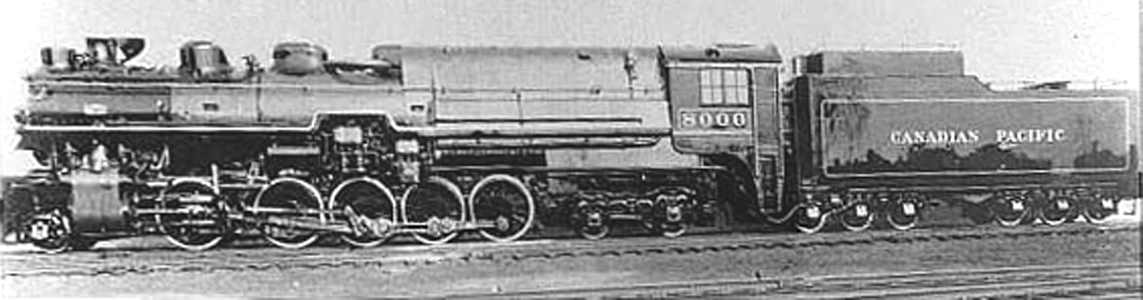

A couple more came to mind,Mr. Mitchell already covered the D&H. The Canadian Pacific played with WTB boilers too.
*edit: Removed offending photo and apologise to group for not being more observant

Wait... is that first picture a gag? CPR 8000 was only a 2-10-4. (and they are both pictures of CPR 8000)

PostPosted: Tue Feb 12, 2013 2:17 am
Posts: 293
Hmm, Joe's onto something. Same engine, two different wheel arrangements? Maybe someone decided the engine needed an extra set of drivers. ;)

Once it's been pointed out, it's easy to see the splice job in the 2-12-4 shot. (The two right hand drivers are one and the same.) it's not a very good photoshop job, can't tell if was a gag or an honest error in splicing two shots.

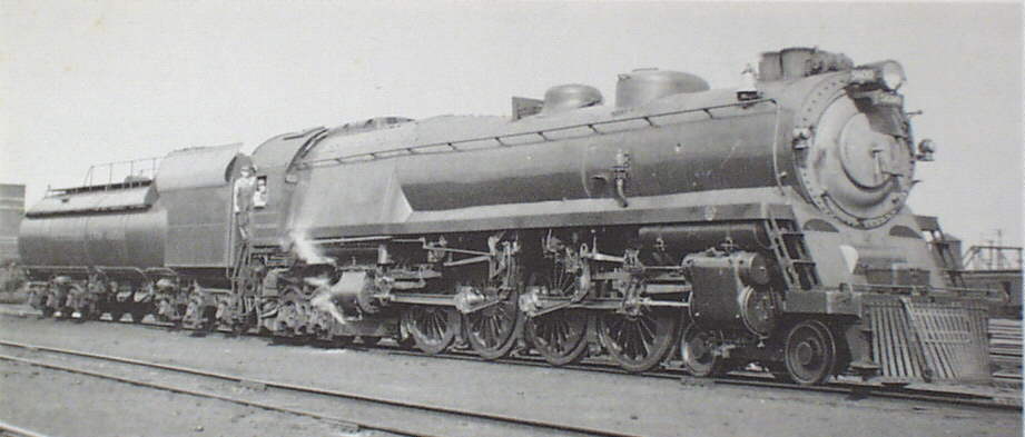

Fixed it
