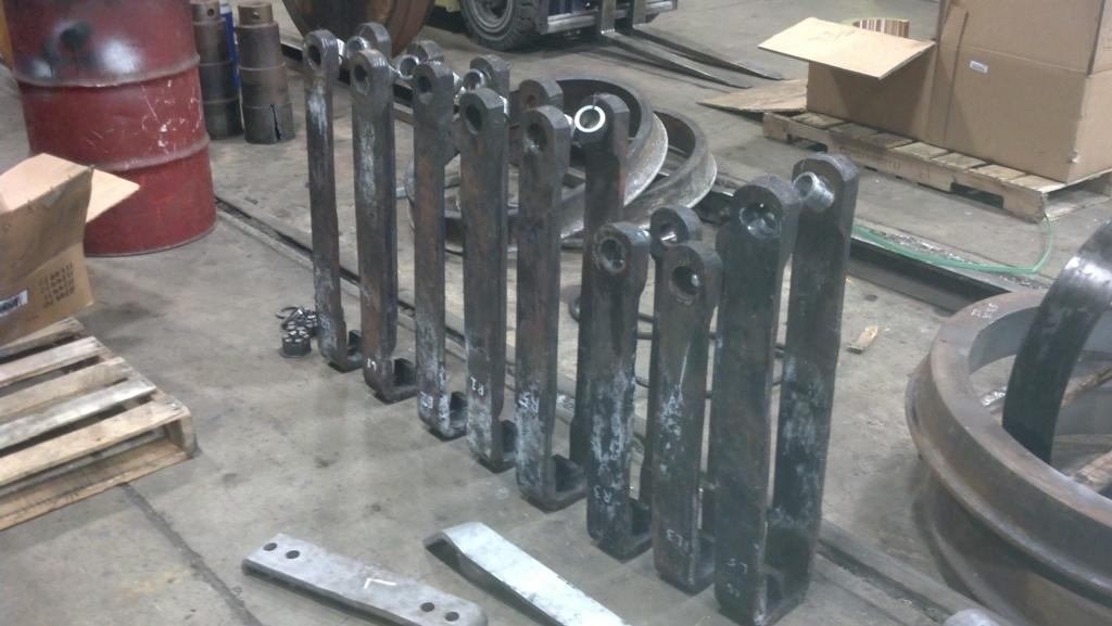

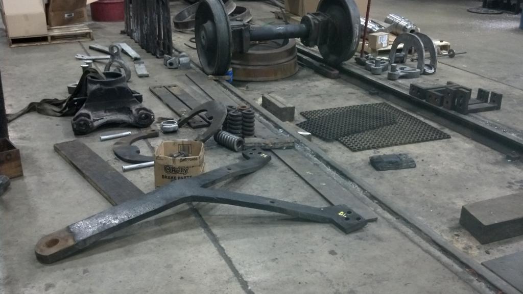

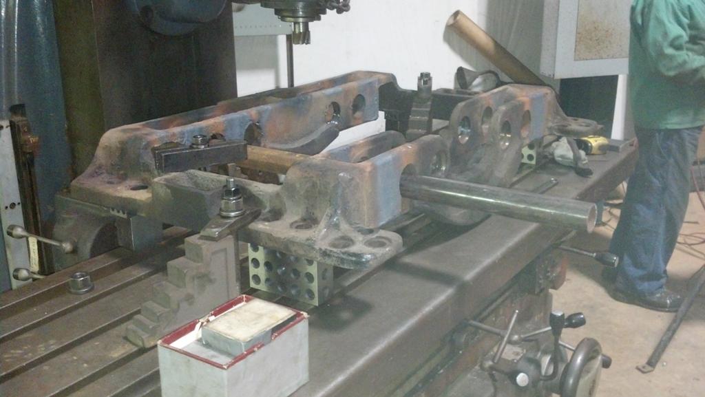

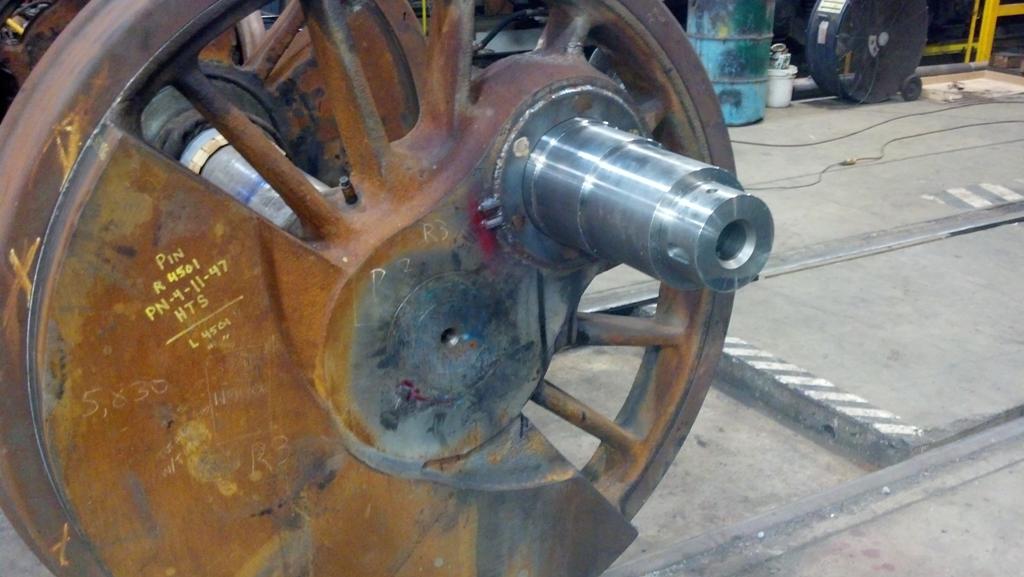

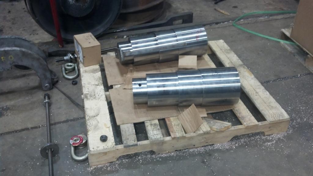

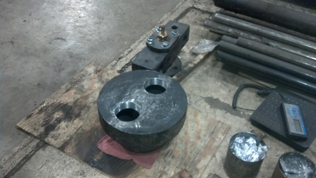

Machinery - The main crank pins were received and installed. This wheelset is now in the journal lathe getting the journals burnished and hubs machined out to the 55" back-to-back dimension. Then its to the quartering machine for final machining of the crank pins and crank pin hubs. Crown brass is being turned for the driving boxes. All the hangers have been rebushed. The lead truck has been disassembled and numerous problems uncovered. The truck frame was bent in two different directions and required straightening. The pedestal legs were worn beyond repair so replacements have been fabricated. The equalizers were also bent so they've been straightened. We're looking at replacement of the very tired coil springs.

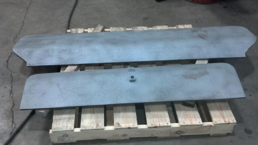

File comment: New inner and outer throat sheet plates

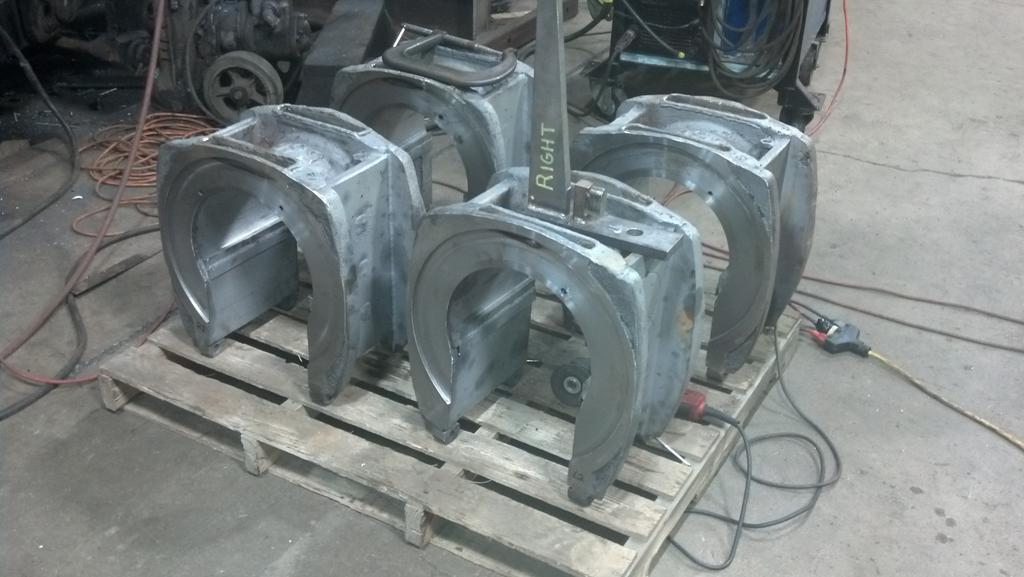

File comment: Driving boxes anxiously awaiting new crown brass

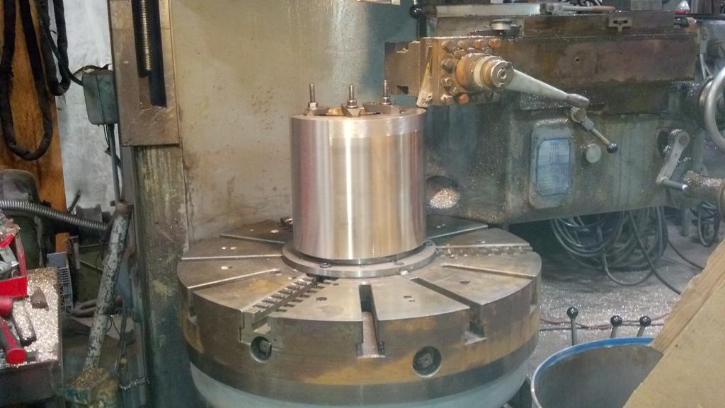

File comment: New crown brasses being turned prior to being pressed into the boxes

File comment: New crank pins awaiting installation
File comment: New crank pins installed in main driver

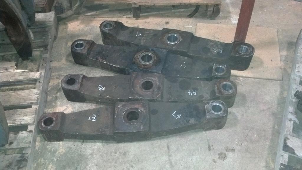

File comment: Hangers being refurbished

File comment: The lead truck after it exploded all over the shop floor

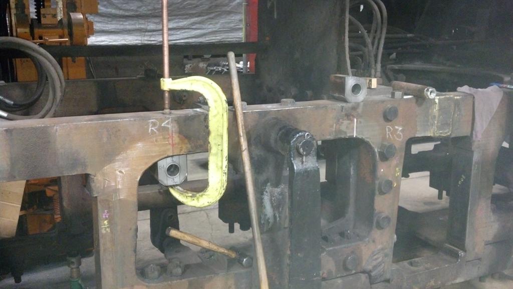

File comment: Lead truck frame on the milling machine. Note the areas that have been heated for straightening

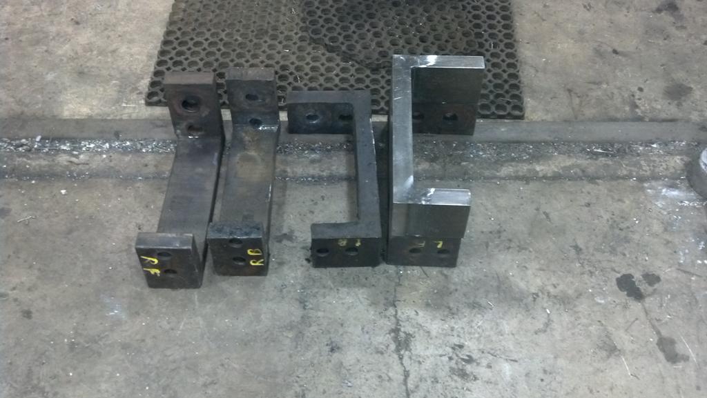

File comment: New dead hanger blocks being positioned for welding to the frame
File comment: Newly cast safety valve manifold and steam distribution manifold (aka the turret)

I'm curious as to why the original dead hanger blocks were cut off the frame?

PostPosted: Wed Feb 13, 2013 7:25 am
Posts: 382
Good question. It appears that the dead block hangers were never part of the frame. We have yet to determine what kept them in position in the original construction. Later drawings show replacement frame sections with the dead blocks cast as part of the frame.

Posts: 343
So I guess that means that the modification shown in the drawings was never carried out?

PostPosted: Wed Feb 13, 2013 11:05 pm
Posts: 382
4501's dead blocks moved without having to jack up the locomotive. They will be welded to the frame now.
4501 did receive a new front frame section (heavier rails) but the center section where the dead blocks are located is still original.

Posts: 374
Hi, Mark.
I am just askin.....just askin.
So, I too have worked on locomotives with what I have called floating dead blocks. Kelly mentions them too. Being that it is true that they are held in by gravity and to date, gravity has not failed us and owing to the fact that the blocks do move a bit even under load.....
Why weld them in? Seems to me that somebody figured out a long time ago that letting them float was the best option. Just askin......what is the primary reason for wanting to weld them in? I would be worried about having to watch that weld and inspect it. Left floating, out of sight, out of mind, right?
Just askin.....
JohnE.

John E. Rimmasch wrote:
Hi, Mark.
Just askin.....
JohnE.
John,
Hopefully Gary can elaborate on the subject, but it seems Southern found a use/need for casting the dead block hangers integral with the frame. Perhaps this is TVRM's reasoning for welding them? Truthfully, whether they're welded or cast, that shouldn't matter as far as their inspection frequency.
My $0.02 anyway...
DC

Posts: 382
Hi, Mark.
JohnE.
Hmmm, the best option?
I've struggled to find the advantages in the dead blocks not being part of the frame. 4501's had moved closer to each other which means the hangers were not longer vertical. The made the effective length of the hangers shorter compared to the one connected to the equalizer. It also created a horizontal force which would cause it to continue to move. The stress on the weld is easily calculated and is less than half the allowable even when considering a dynamic load factor of 3. I am not going to worry over it.
Southern's later M Class locomotives had integral dead blocks. I chalk the "floating" dead blocks up to someone who thought they had a good idea but it just didn't work out too well. I also include the Hodges trailing truck in that same category. This could be a thread of its own, ideas for steam locomotives that just didn't work out. Would compounding top the list? Hmmm, the N&W proved it could work :-)
The K Class locomotives had integral dead blocks and they predate the M Class.
