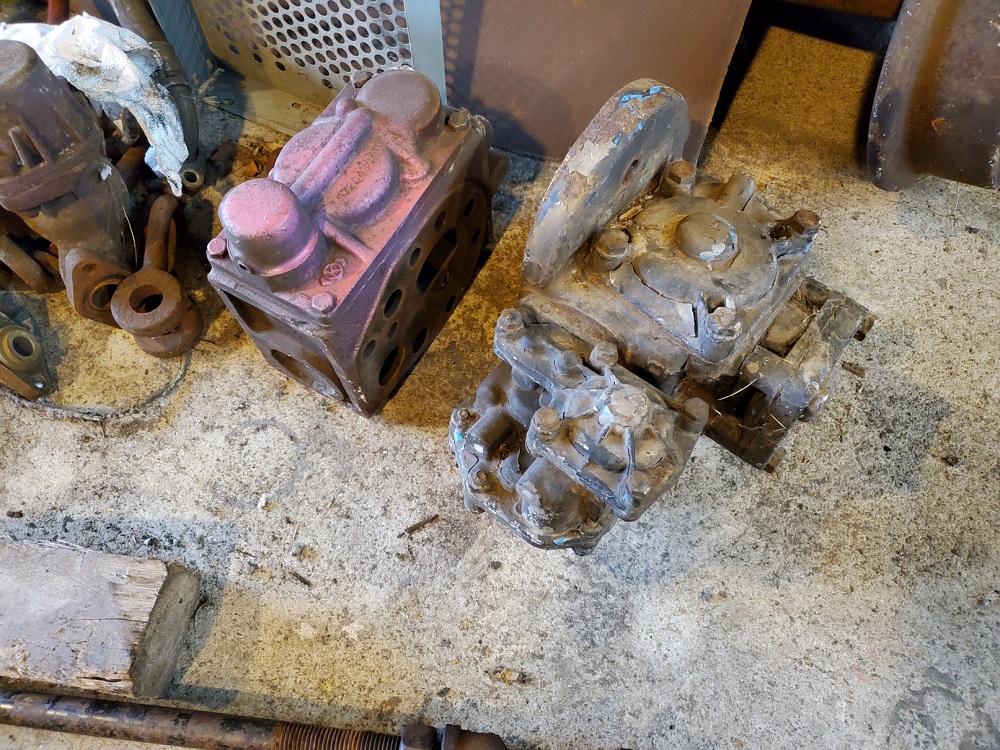

PostPosted: Sat Nov 27, 2021 9:19 am
If you would like to upgrade to ABDW brakes on that car, I have a set of control valves off of a CSX boxcar that I would give you. Emergency portion is good. Service portion doesn't release so it would be good as a core for unit exchange.
