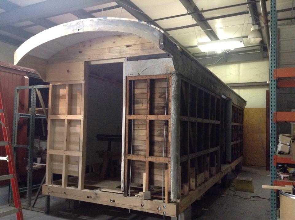

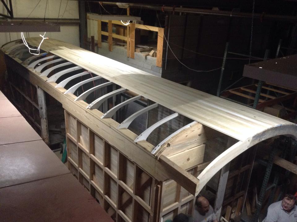

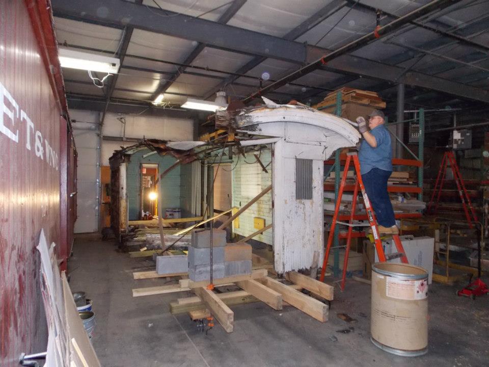

In July of 2012, the Alexander Chapter-NRHS was able to rescue the sole remaining narrow gauge baggage car left with a southeastern provenance (and one of only two extant arch roof NG baggage cars. We moved the car into our shop in March 2013, and just over a year later, I thought I would share some of the progress and ask a couple of hopefully simple questions....
First- on the emergency train line cords/ropes that run thru the cars, how did the cables connect from one car to the next?
Secondly- builders records show that the car body was painted "Pullman". It is explicitly stated so. Well, ok. Unfortunately, the paint left under the siding of this car looks more UPS Brown than Pullman Green. Believe it or not, the siding we removed certainly looks to be the original- no extra nail holes, etc. like we have found under siding in our other wooden cars. Any thoughts/comments on the nuances of "Pullman" (yeah, I said "hopefully" simple question."
Thanks in advance- here are a few photos...
