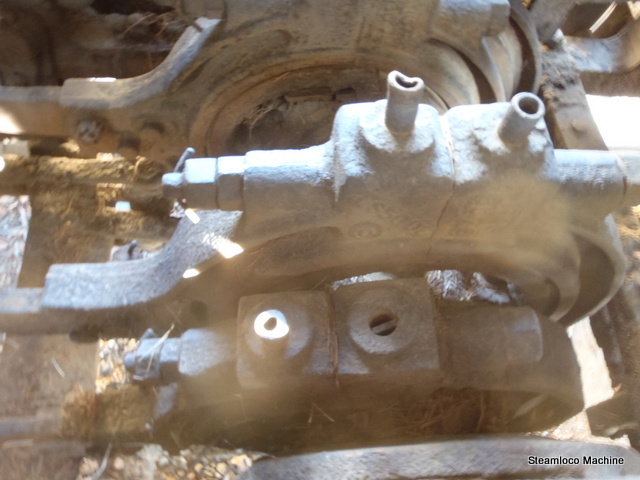

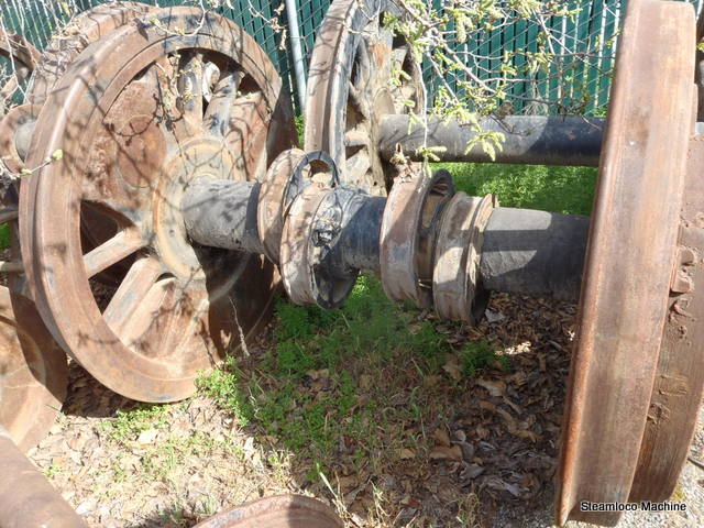

There are 3 saved SP class c-8 2-8-0s but all are missing the eccentric blades and pistons which were removed by the SP when they transported the engines to the display sights. The 2706 John Manley is trying to restore is being enclosed in a repair shop in Colusa, CA. It has the eccentrics but they are of unusual construction in that they look like flat belt pulleys with flanges on both sides. We are trying to get any information on the valve gear, valve settings and eccentric blade designs used on this class of locomotive so that the missing parts can be made. That information will also be useful to the other two engines, 2720 at Compo and the 2718 at Alturis.
The C-10 #2852 in Orland, CA is complete but does it have the same valve gear?
Any help will be appreciated.
File comment: 2852 Orland C-10

File comment: main driver and eccentrics of 2706

I read that the SP's 3' gauge #9 had the same eccentric design as in the bottom photo.
The story goes like this:
When the SP's "Laws to Keeler" branch was on its last days, the "flange" wore off of one side of its eccentric (the flanges in your photo) and the eccentric blade fell off the eccentric and down onto the driver axle, and thats what stopped the last of the SP 3' 4-6-0's in CA.

Morning Dave. I'm no expert on the SP consolidations, but that is, from the looks of it, your standard stephenson link motion. Some of the photos of inside-cylinder engines under restoration in the UK that I've seen have those same ports, which were used apply lubricant the motion through connection to a lubricator (the most common that I've noted is the Wakefield design) with flexible hoses.

Oh boy....in general terms, the straps either have flanges on them or the eccentrics have flanges on them, but of there are flanges on both it would act as a bearing labyrinth and help keep dirt out. So, you have interesting options here......as well as choices about bearing materials, lubrication systems and lubricants......have some fun with it.

To the best of my recollection, the eccentrics on SD&A 104 (SP 2720) don't look like the ones in the posted photo of 2706. I'll be out at Campo this weekend, and, if I have time, will try to get a couple of photos. (Teaching an all day long class for new brakemen). I do know that the eccentric rods have been removed, but I think we have them. Might take a while to dig them out for photos.

And yes, the valve gear under the C-10 2852 is very close to what you should have.

SteamerDave: Well, I guess my memory isn't as good as I thought. Friday I climbed up over the drivers of SD&A 104 (SP 2720) to take a photo of the eccentrics. No eccentrics on the axles! I poked around in our storage area a bit, and found the eccentrics: just like the ones in your photo of 2706. I didn't have too much time, but did look around some more, but could not find the eccentric straps or rods. That doesn't necessarily mean they aren't there, though. Lots of parts from all of the five steam engines we have, all piled up in no particular order. Then there's the other storage area.......
