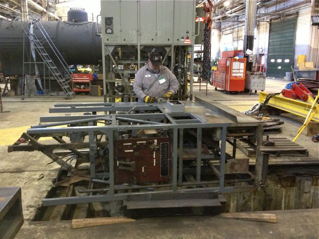

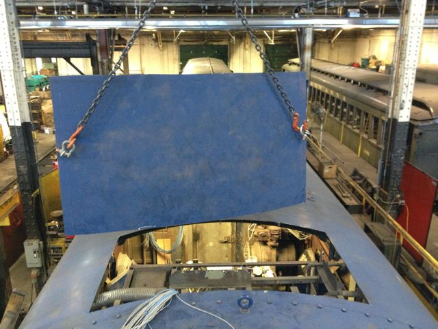

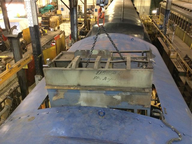

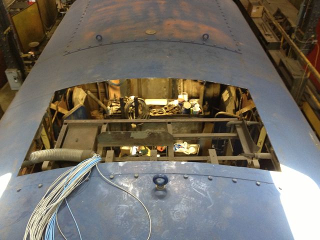

B unit - this locomotive has finally been getting some long overdue TLC as it has been the main work project for ARHS volunteers this past winter. It has hibernated inside the Steamtown roundhouse which allowed considerable rust to be removed from the inside and spot priming and painting to take place. All the fabric covered lo-volt control wire was removed and about 4000 ft of new Exane wire pulled thru the main conduits. We were looking to restore the main electrical cabinet relays and other component on a piece-meal basis when we were given a tip that NS had complete F-unit electrical cabinets which were headed for the scrap gondola. These were removed from their Executive F units this past winter as they were upgraded to AC. Thanks to some great contacts and friends and some quick phone calls we obtained the complete cabinet from NS #4275. Since this is a modernized cabinet with a modified layout of components it was decide to reverse what NS had done. We moved ahead with a plan to remove the existing electrical cabinet from the B unit and replace it with the one obtained from NS. This requires work in Steamtown's main shop with the big overhead crane and cutting a hole in the roof. The old cabinet came out on April 25 and it is hoped that the "new" will be installed this coming week. Not sure how many other groups have done this extensive electrical work. The plan is to get all the wiring connected by late summer.

File comment: Lifting the old cabinet out. Note the hand written 6150 number which is the locomotive's builder number.
File comment: Hole in roof. Looking down on the old cabinet. EMD never put a hatch above the electrical cabinet. The never thought these things would be around for 60+ years either.
File comment: Roof panel comes off.

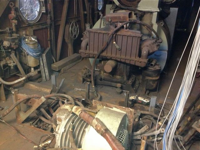

File comment: Old cabinet resting horizontal with the NS cabinet behind it.
File comment: Big empty space where the electrical cabinet should be. Note on the far left the hostlers controls by the porthole.

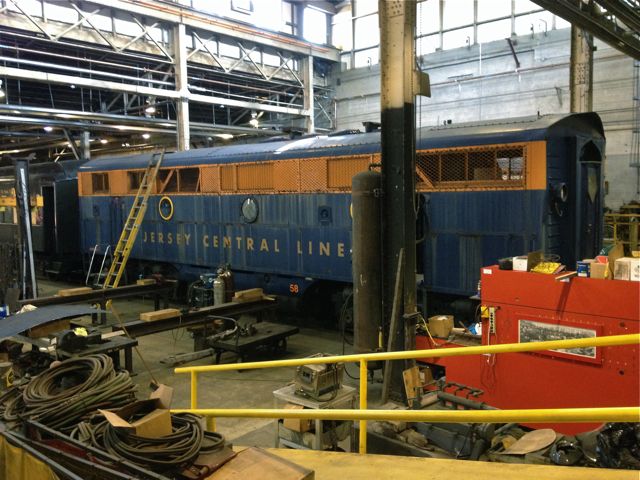

File comment: The B unit in CNJ paint is former B&M #4268B. So in this photo two B&M locomotive are on adjacent track and from what I am told both were together on the B&M roster for about 5 years.
