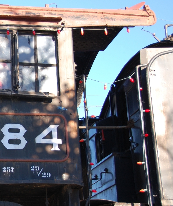

Every 1:1 scale steam locomotive I've ever been on had one.
If you look at the engineer's side of the tender, above the sand box, you will see a red handle pointing up. Location varies.

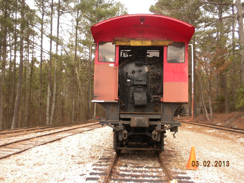

Here is the Emergency Valve on the 60 at Stone Mountain. On the firemans side of the cab. The valve is piped into the brake pipe and provides a way to "Big Hole" the train brakes.
Mike A
W&L 203
