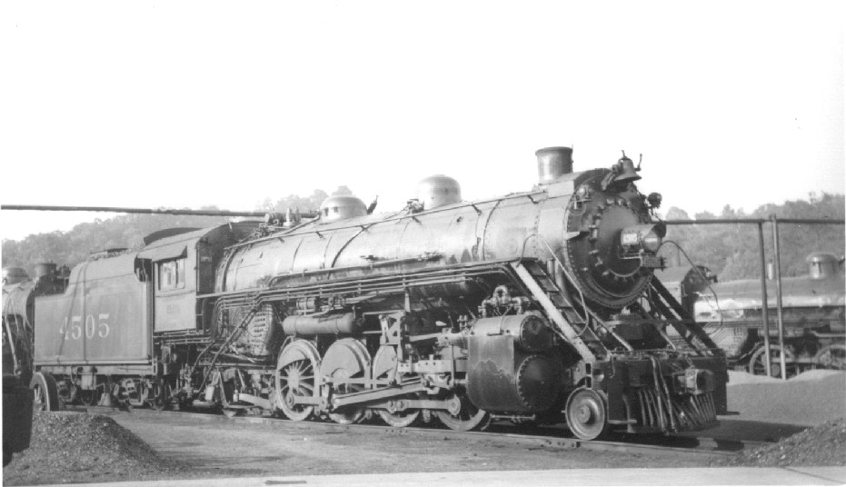

I truly doubt it will ever happen but, I would love to see her dog house and dooley bonnet come back! In my opinion, they are two of the most distinctive features of Southern steam! Almost all the locomotives in freight service had some form of smoke deflector.

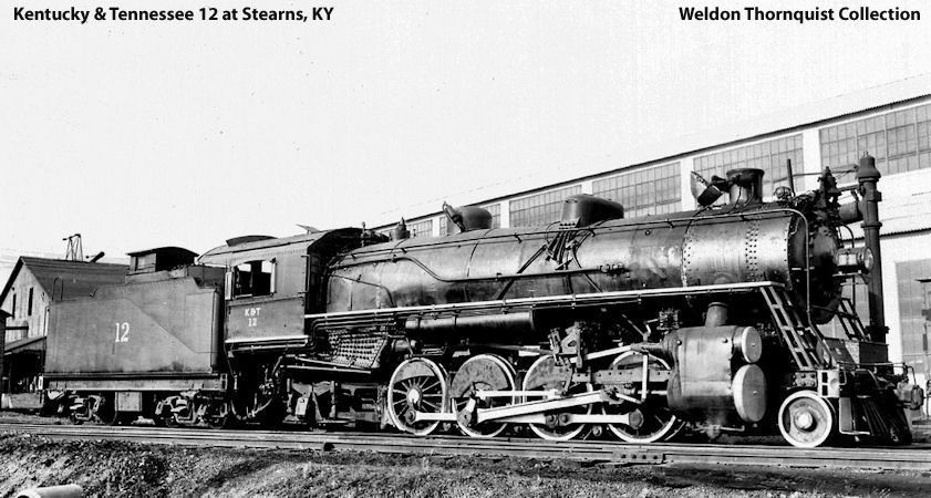

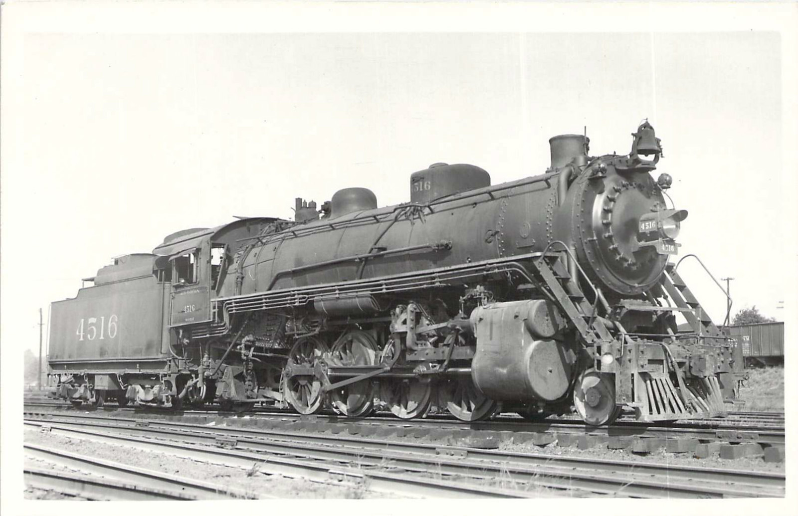

Btw, for those of you who are curios to how the Southern mikado locomotives looked with Worthington feed water heaters, here are two photos.
