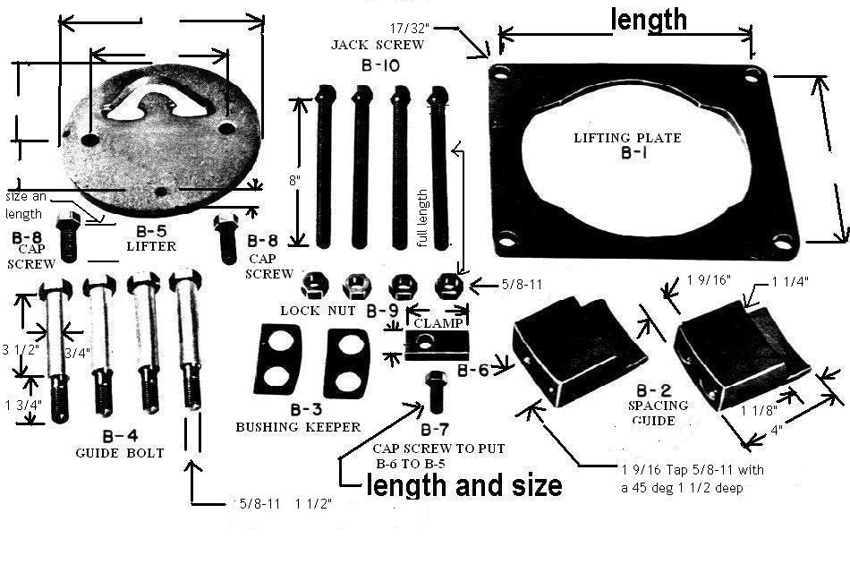

The Fig. 1-8 lifting cylinder
The is the way to lift in vertical by inclined plane that tilt it 45 deg. I need distant from head to 3/4" in middle an distant to chain.
I need the eye bolt from top of head the middle eye an size that it require.

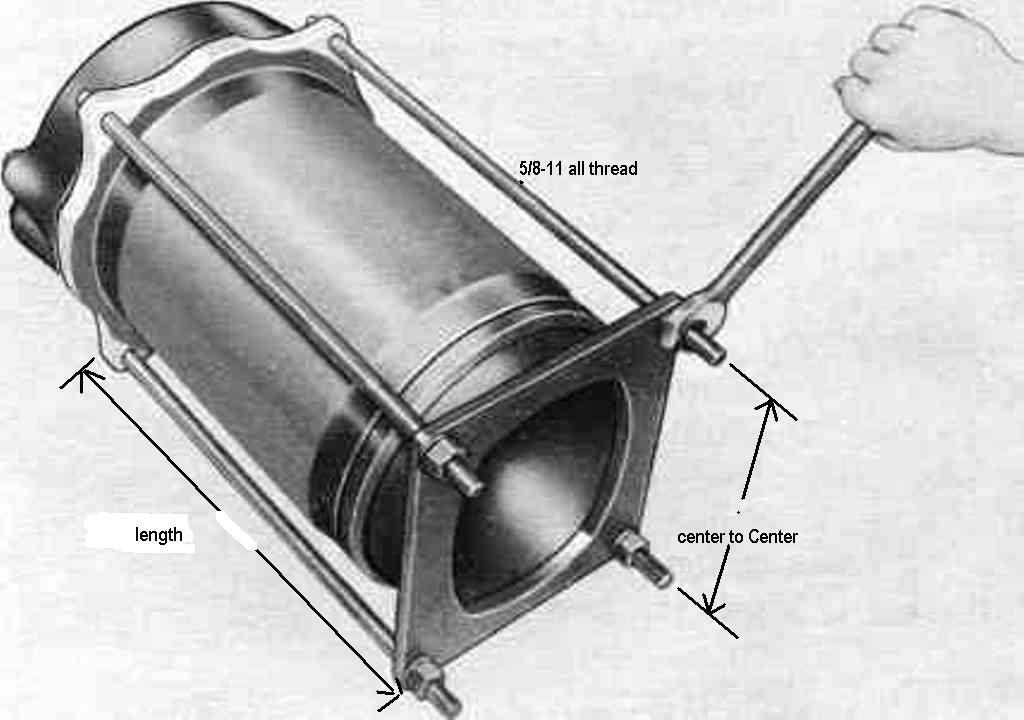

The is water jacket an liner separation device that I need (4) 5/8-11 long all thread an center to center which should be the as <www.railswap.org> item Lifting Plate B-1 a should also use Lifting Plate B-1 for tool.
The is <www.railswap.org>
All dimension on the drawing I do not have.
Some are there but the one's I don't have is the problem.
If you can find a drawings, or the measured items at email to me, take the drawings a sent the back to email address.
Thank
Stan Paulsen

File comment: The Fig. 1-8 Lifting cylinder head
FIG 1-8 Lift head.doc [47.5 KiB]
Downloaded 332 times
File comment: The is water jacket an cylinder to remove
File comment: The is <www.railswap.org>
Need the bolt an length of parts

OK, despite the language issue, what he is looking for are the dimensions that are missing on the sketches. If someone has drawings or knowledge of these dimensions it would help him.
