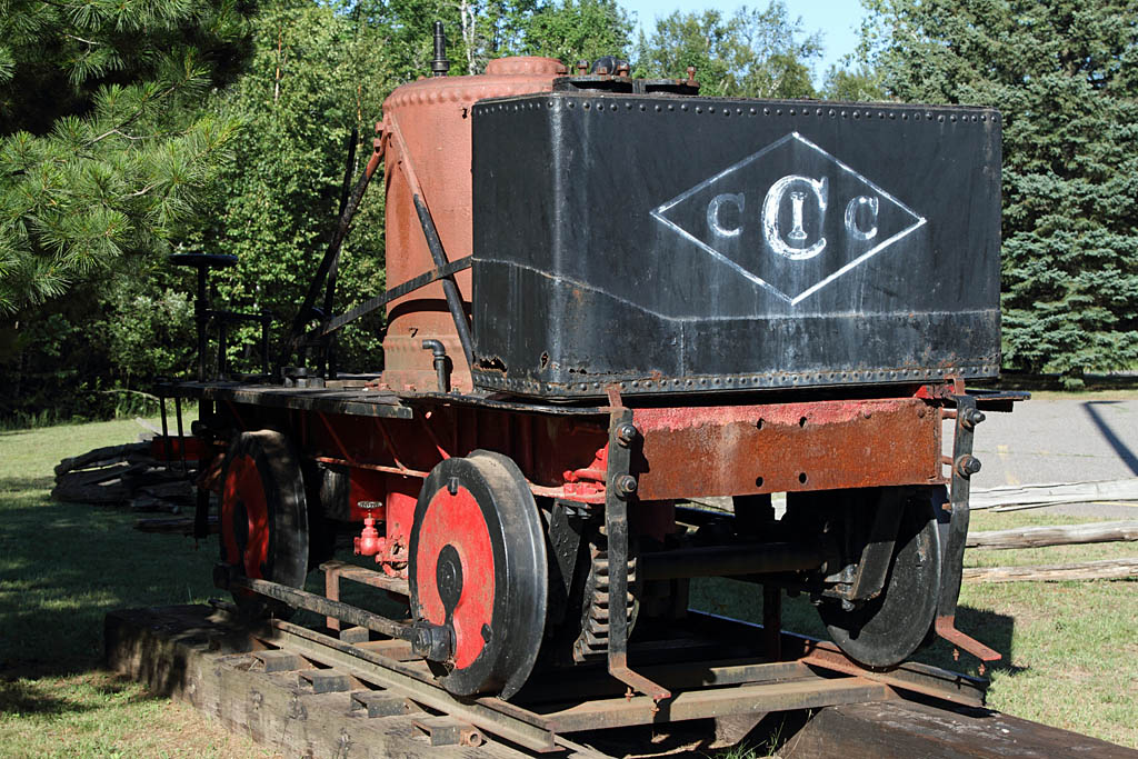

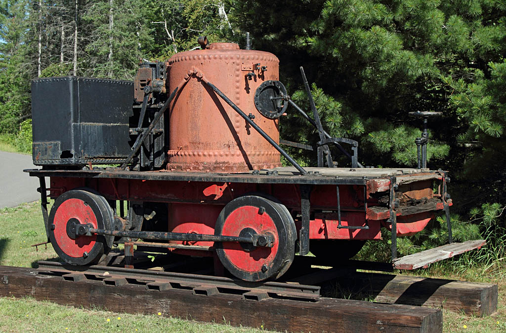

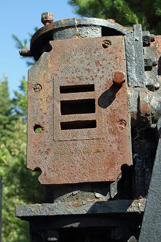

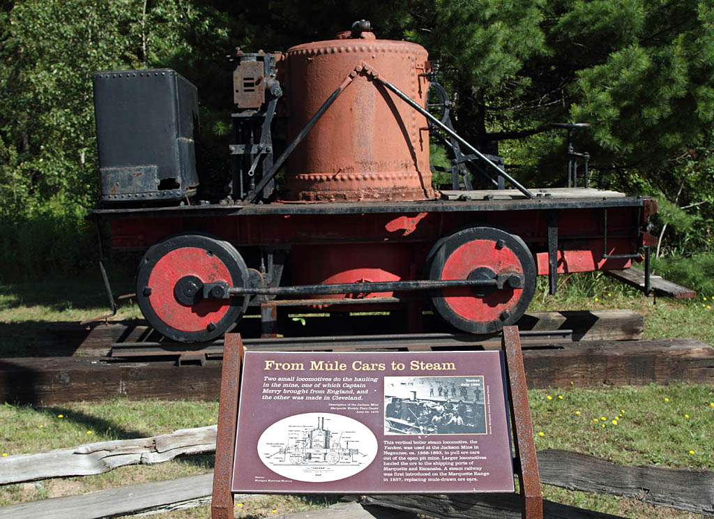

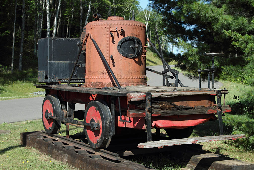

 Post subject: Yankee 2012
PostPosted: Sat Jul 21, 2012 6:57 pm
Posts: 282
I had a chance to look over Yankee a few weeks ago. The museum has been unable to make a positive ID as to its builder. I'm beginning to think that the frame/wheels are Chaplin, mated with a replacement boiler from Cuyahoga Steam Furnace. Everything I've seen and read about Cuyahoga Steam Furnace suggests that this is not one of their products. Comments?
 Post subject: Re: Chaplin Locomotive Mystery
PostPosted: Sat Jul 21, 2012 6:58 pm
Posts: 282
Two more....

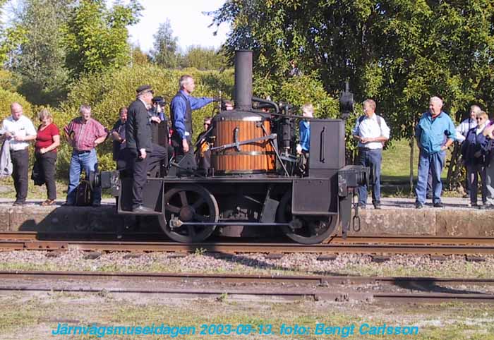

David,
I took an interest in this loco while working on the 12, and have a few items I'll send you.
Attached to this message is a pix of a Chaplin locomotive that was in operation in Denmark.
Robert Yuill
http://www.historicmachineryservices.com

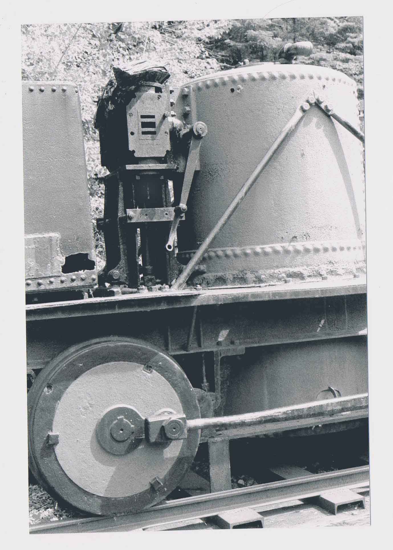

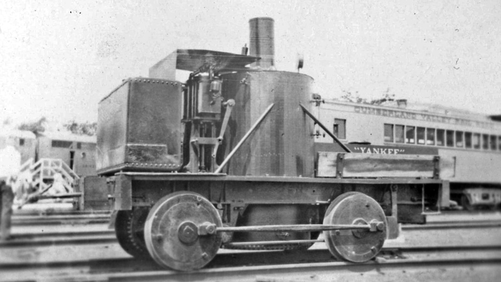

 Post subject: Yankee undated photo
PostPosted: Mon Aug 06, 2012 5:33 pm
Posts: 282
I recently purchased this photo of Yankee at an unknown location (looks like a major event - perhaps the Chicago Railroad Fair? - note the F units and Cumberland Valley combine "B" in the background). It would appear that Cleveland Cliffs restored the engine to operable condition after it sat abandoned for many decades. This photo raises so many questions. Why is the locomotive incomplete today? Where did its parts wind up?
Jeff Terry
PostPosted: Mon Aug 06, 2012 9:08 pm
Joined: Tue Oct 12, 2004 9:32 am
Posts: 119
Location: Alabama
Great pix, but take a closer look. Where are the piston rods?
Robert Yuill
PostPosted: Mon Aug 06, 2012 10:00 pm
I see the piston rod very clearly on the near-side cylinder, going down to what is probably the upper part of the crosshead just above where the side rail blocks further view. You can plainly see the gear on the inside of the left-hand wheelset that the pinion on the crank, driven by the main rod at the other end of the crosshead (which will slide on the "bars" that form the bracket), will engage.
What is the problem?
PostPosted: Mon Aug 06, 2012 10:08 pm
Posts: 119
Location: Alabama
I see that rod, but I do not think it is a piston rod.
Also, there is another lever with a pin hole connected to .....?
Robert Yuill
