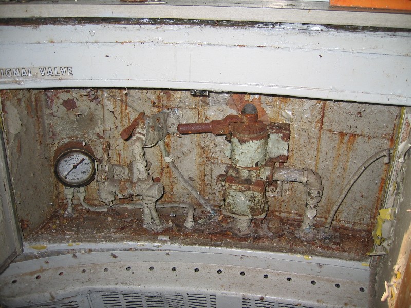

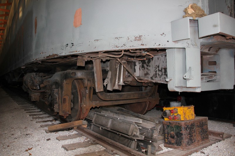

Speaking of horns on the rear of tail cars...
Here is what was hiding behind the skirting on the rear of the Gulfport, an Illinois Central Panama Limited round-end obs.
And inside the car, showing gauge, signal line valve, horn valve, and conductor's valve.
