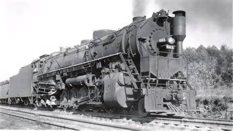

Hi all
I was doing a search on the web and I came across this photo , What is the device in front of Smokebox ????? Pat.

Looks like a shield for a pump mounted on the pilot deck.

The engine appears to be a Bessemer & Lake Erie 2-10-4. Looks to me like some sort of experimental rig, perhaps something to do with cinder collection?
Didn't show up in any of the several B&LE publications I've seen.

I strongly suspect that it is some sort of experimental adaptation for the burning of a really low grade of lignite/powdered coal. The T&P tried this on a couple of engines and they were all called "Snuff Dippers"

Special cinder collector.
http://books.google.com/books?id=f75iQO ... -4&f=false

Thanks Tom,, you found the answer , Pat.
