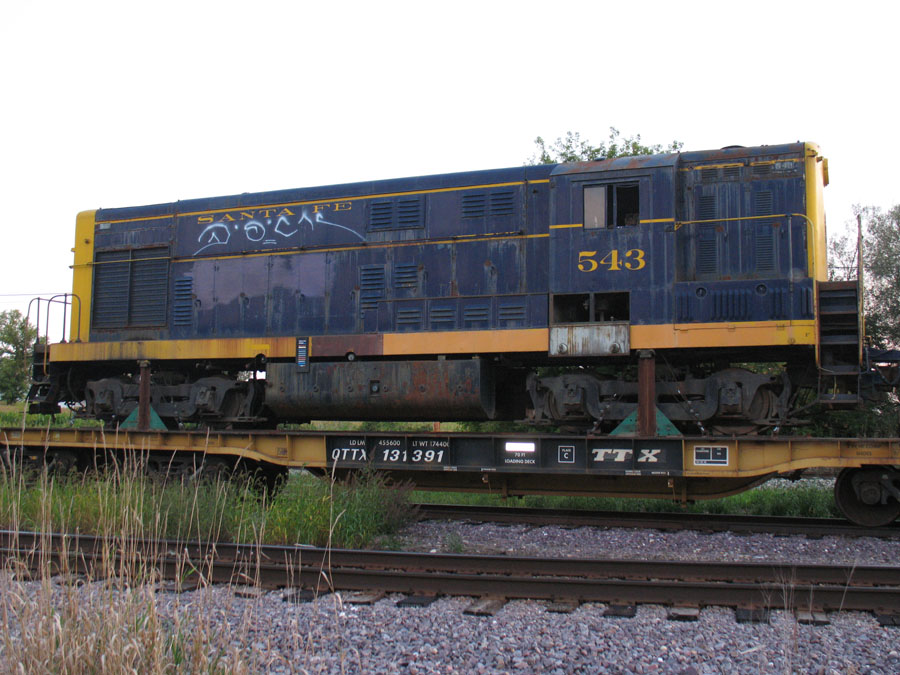

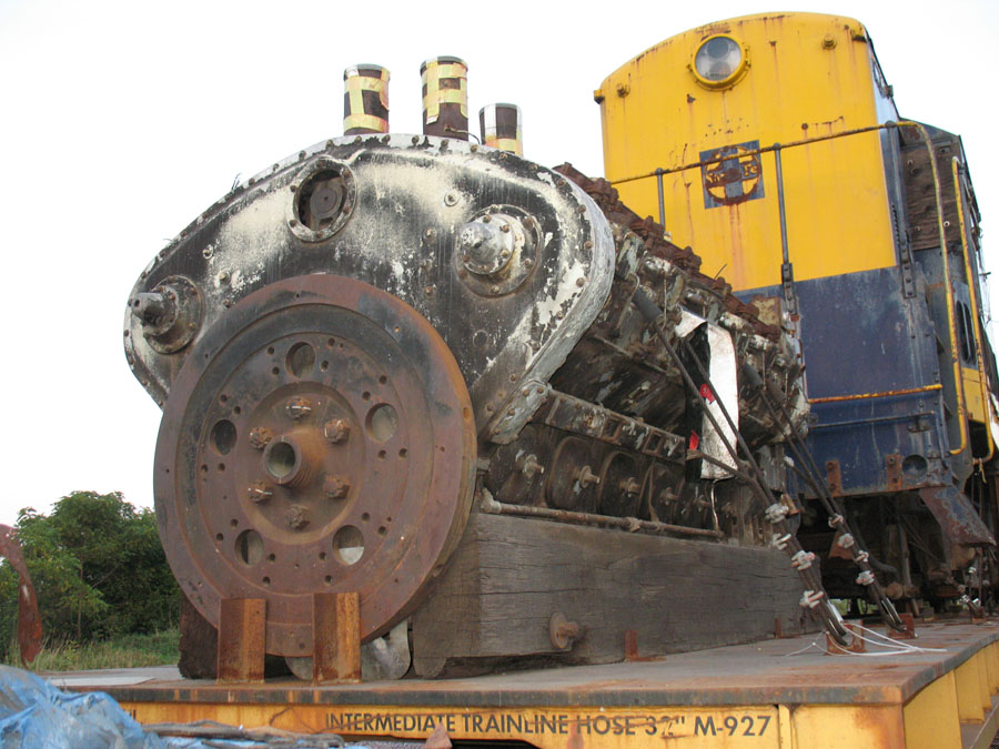

The QTTX has enough capacity (and room) that when you're sending an H-12-44TS halfway across the country you can send a V12-201A along for the ride.
